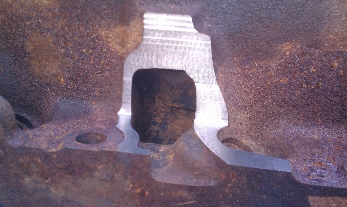

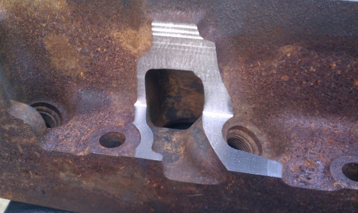

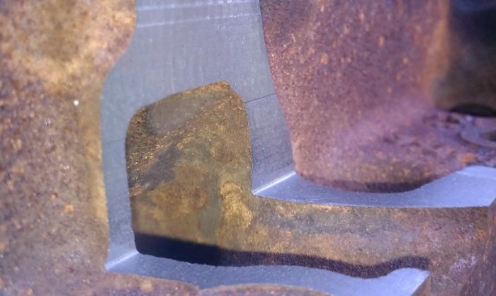

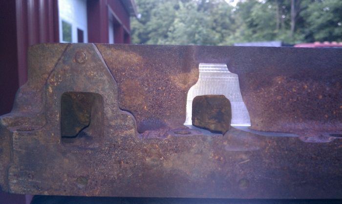

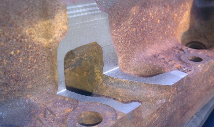

I finally got the head back. I just had him cut one exhaust top off, and from what I can see there would be a LOT to gain if the port were continued in an upward travel with custom headers. Here's some pictures of the cut head.
These angles show how the port is really still in a near vertical angle as it exits the head. If the angle were continued with a gentle slope outward, it would make for a nice smooth flowing exhaust port.
This shot shows how the height is essentially the same as it exits the head, as it is when it exits the exhaust port. But given the vertical angle of the port at the head exit, it really shows how sharply the port bends in that short area in between.
