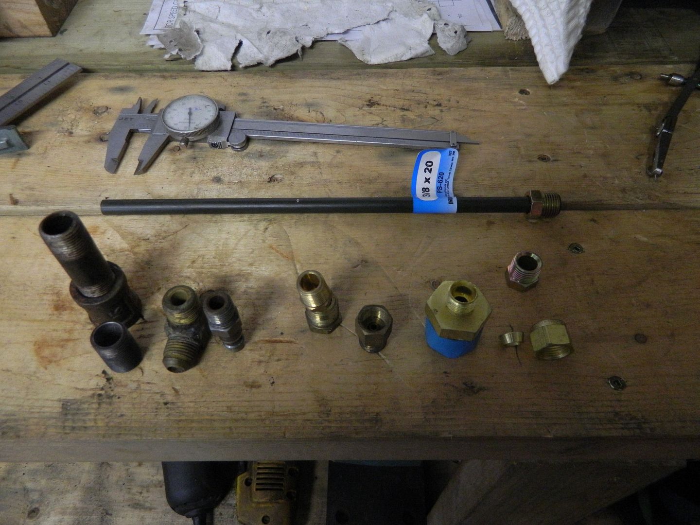

Re: Fuel line plan?
« Reply #18 on: April 30, 2014, 04:06:31 PM »
Fittings. Not all fittings have a standard bore.
A 3/8 NPT can have a smaller bore than a 1/4" NPT.
Just depends on which bin you get the fitting from.
Here is a pic of a handful of fittings I scrounged up to take a pic.
The 3/8 NPT elbow has a smaller bore than the 1/4 NPT quick connect and so on.
The Swage is a really odd one. 3/8" pipe to 1" NPT. Ok ::)
The 1967 Fairlane 427 8V ran pretty good on a 3/8" line and Carter type pump with 1/4 NPT fittings.
