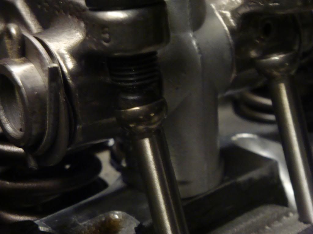

I have a metal line from the pump, that goes to a rubber line and the metal fuel filter, then rubber to the carb. Here's a picture. I have re-routed it so the filter isn't resting on the valve cover. I'll try the spacer this weekend, I'll also see if I can source a plastic fuel filter. If that doesn't help I'll have to consider the electrical pump. What's a return line used for?

From the photo you posted I'd really be wary of that line between the pump and carb.
Looks like it could be in contact with the radiator "catch basin" (as I like to call it :) too.  Definitely want to get the hose and filter moved, they'll act like heat sinks when you shut the thing down.  In the past I've bought the hard line you can get at any auto parts store that you are able to bend easily enough without any tools.  Form it up so that it's a couple of inches away from anything hot.
I've also stuck my filter between the pump and incoming fuel supply line where you currently have a length of hose leading to the hard line on the frame.  If your setup has the room you can do that too.
I realize these are el-cheapo type fixes ::), but if they help you identify and fix the problem you can upgrade accordingly.
