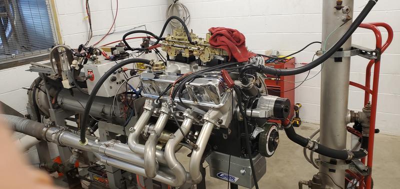

After several years of curve balls, and a couple of bean balls being thrown at me by life, I finally got around to getting Blair to put this engine together and dynoed. The goal was a stout street/race engine that I could have fun with at the track and still do a Drag Week event if I decided to do so again. That meant dependability and durability was a priority. I also wanted something strong enough that I could easily up the ante, should I decide to do so in the future, which seems to be a constant with my Mach.
I spent an entire day at Blair's dynoing the engine, and after getting the A/F right with jetting, he worked his magic on the 660 carbs, not exactly known for their streetability. Watching someone who truly knows how to tune an engine, not just getting A/F right, but actually working the carbs in a staggered fashion to get each cylinder even and performing to its potential was a special treat. I've been around a fair number of dyno runs, even in competitions, and I can tell you that there are only a limited number of people who can tune like Blair. He picked up another 25+hp just by balancing the cylinder mixtures for each cylinder, and on a single plane Tunnel Wedge to boot. He also adjusted part throttle/load mixtures to get a smoother street engine, then worked the idle mixture to make for a much smoother and happier engine overall. It sounded like a different engine by the end of the day.
A huge thank you to Blair for putting this together for me, everything he taught me while I was there (again), and his great crew at his shop, who helped me fix a busted brake line that happened just as we were loading the engine, right before a 500 mile trip home. 10 minutes later and I would have been going 75mph on I-75, so the Big Guy upstairs was looking out for me.

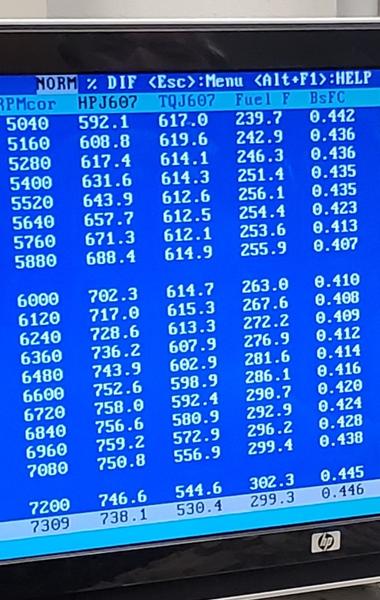

Torque was flat as a pancake for 1500 RPM, and the HP nearly matched it. A 1.59 HP per CI is impressive. I've got some work ahead of myself to make the car ready for this engine. Luckily, I've already got 95% of everything I need, I just waited to match a fuel pump and system for the horsepower, and new 5 point harness so it wasn't dated out.
Engine specs....
Performance Summary:
      Cubic Inches:  475
      Peak Horsepower:  759 @ 6960
      Peak Torque:  619 @ 5160
Engine Specifications:
   Block: SOG Iron Block  4.35 Bore
   Crankshaft: Crower 4.00 stroke, 2.00 rod journal
   Connecting Rods: Crower
   Pistons: CP, 11:1
   Camshaft: Bullet custom solid roller
   Lifters: Crower HIPPO solid roller
   Cylinder heads: BP Pro Port
   Rocker arms: T&D paired, custom offset, custom ratios
   Pushrods: Manton 3/8 x .145
   Distributor: Ford, vacuum advance removed, custom curve
   Intake manifold: TFS Tunnel Wedge, worked and matched to Pro Ports
   Carburetor: 2x Holley 660
   Balancer: ATI Super Damper
   Water Pump: In car a CVR pump and FEPower adapters will be used.

Very nice, that will be fun.  4.00” stroke, small rod journal, it shouldn’t mind being upstairs.  I’m with you on the tuning portion.  Once to the floor, bump the key, and it’s idling smooth at 1,000 rpm exactly.  The throttle response doesn’t even make sense to me. It reminds me of an old friend that raced the NASCAR northwest tour, a Braswel 390 cfm 4 barrel, so crisp.  Not sure what you’re looking at in the fuel pump area, I went Magnafuel MP-4601.  So, adjustable bypass, 10AN in and out, and the volume I wanted, then an adjustable 4 port regulator at the engine, so far very pleased.

great build for a killer car.how did the oil pan do on the dyno?as for oil presure.i am trying to decide for my build between that pan and the wide pan they offer.
Re: BP 475 FE For My Mach 1
« Reply #11 on: October 10, 2026, 05:05:16 PM »
Oil pressure was steady on the dyno with the deep Canton pan and screen tray. I'll be using an accumulator in the car, just to be safe. I stayed away from the wide pan because it limits the available space for header primary tubes. Things are already tight in a Mustang compartment.
