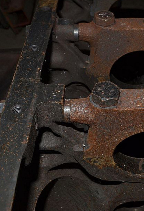

FERoadster here (now). Just got home this evening.
I was in Parker Colorado (near Elizabeth Co.) for the past 2 weeks and saw your message but couldn't reply because I didn't have my password. Message did go to my cell phone.
I will get photos tomorrow of each side, the front and rear bulkheads and the date code, I will also take a photo of the cross-bolt bosses and crow's feet area.
I'll post them on this thread.
Richard >>> FERoadster
FERoadster
Re: C5AE 390 block cast with cross bolt bosses
« Reply #21 on: November 03, 2025, 01:50:54 PM »
Pictures attached.
Block has a date of 1964 and day of 9 but cannot tell the month. Would someone take a guess?
Block is C5AE-A and main saddle supports are the early style and not crow's feet (reinforced). It is a DIF block.
No other special info.
Thank you very much for the pictures Richard.  The letter denoting the month looks like a G(July) to me.
  • Posts: 1960
« Reply #23 on: November 03, 2025, 02:39:30 PM »
Your picture actually does show your block has the “crows feet” main webs.
And my guess would be “G” for the month also. A “4 C” would likely be too early for a C5AE-A block, and no other letter used would have that shape.
*And I’ll just edit to add - there is also usually a stamped assembly/test date code, often on one of the corner ears of the block, or on the front, and that will often help confirm the casting date code. Most common FE engines were assembled anywhere from a few days to a couple weeks after the block was cast.

I didn't realize there are 2 or 3 "crow's feet" styles (Thanks Kevin) Here are 2 other types I've got. Also, the D4TE block date.
The C5 block I said was an old style since there is a window in the main saddle support. Just realized that the window is caused by the cross-bolt boss.
 I've got a 3rd type but couldn't get a good picture today.
Richard
