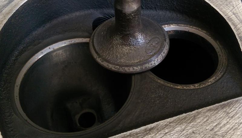

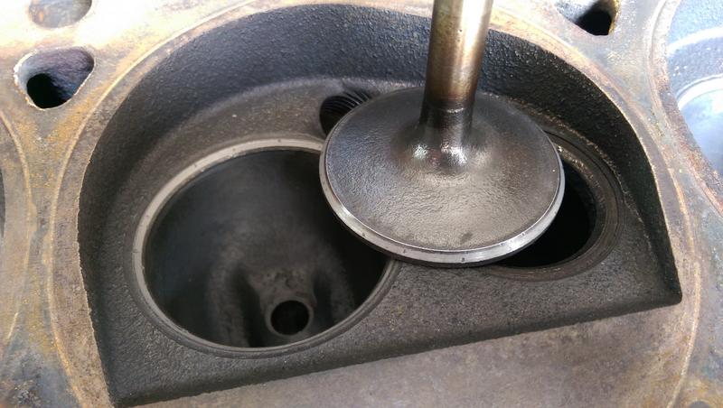

The 390 in my '65 Galaxie was untouched and had never been apart. When I was getting it ready for Drag Week 2018, I took it down to the shortblock to clean out all the sludge that had accumulated over the 53 years. Having taken the heads apart, several of the valves were pitted fairly badly...not uncommon. I simply ordered 3 new valves, lapped them in, and seeing there was a consistent mark around the seat and valve, put it back together....and drove it 1000 miles to Atlanta, then 1000 miles back. No issues, no excessive blow-by, and the engine still runs good today.
Could it be better? Yes. Is there anything wrong with the way it runs now? No. I saw no reason to spend $1k in totally redoing the heads for an otherwise original and stock engine. Sometimes "good enough" is good enough.

      P.S. Just a note, this to "aid you" on "your effort":  Now I'm not there . . . . . . but of perhaps less than ideal, it looks like on the intake valve the seat contact surface "runs off" valve face, both intake & exhaust seating surfaces appear "sorta wide" not to mention "bad transitioning" with "no back-cut" on the valves nor additional angles "defining" the seat face angle in the cylinder heads.  Now there may be additional "concerns", but like I said, I'm not there and this is just what I noticed in glancing at your photos.   ;)
