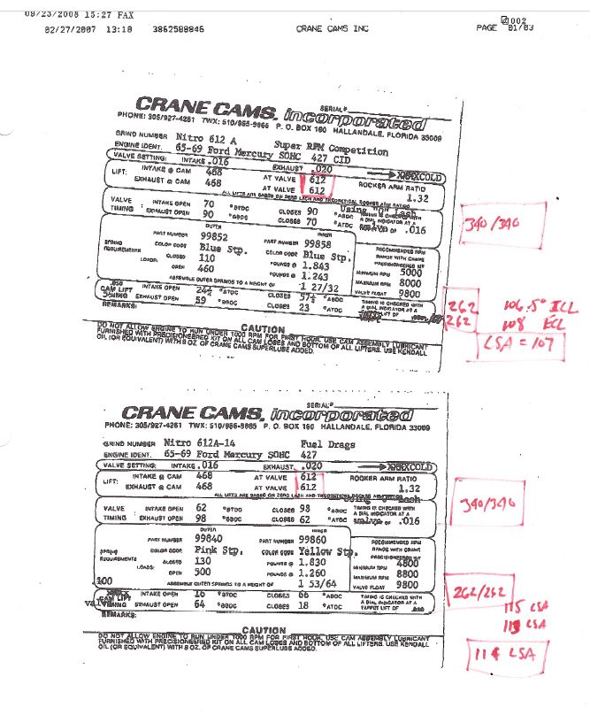

I'm looking for the complete cam card information for the Crane 612A grind SOHC cams. The Crane catalog from the day does not give complete specs. Thanks!

Here they are, with some of my hieroglyphics in red:
