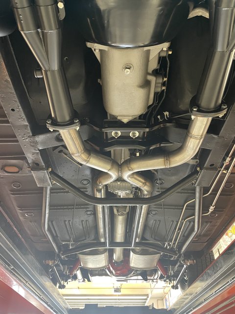

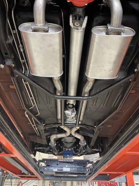

I don't have any good videos, but we have the same setup on the '67 Mustang. REF's, X-pipe. It's nothing like you're describing. Definitely louder than stock, but the noise level isn't much different than when the car had FPA tri-y headers on it and an H-pipe.
I'm not certain what mufflers these are. We asked the exhaust shop to make it sound acceptable and streetable and this is what he chose.
https://www.youtube.com/watch?v=USdS3deCBC4
https://www.youtube.com/watch?v=nWn1tm4IdtE

Nice Car!
I noticed you don't have the right side torque box. But you have the chassis stiffener?
I consider that a must have for a high HP road car more so than the chassis bar.
Everything to stiffen the front steering.
