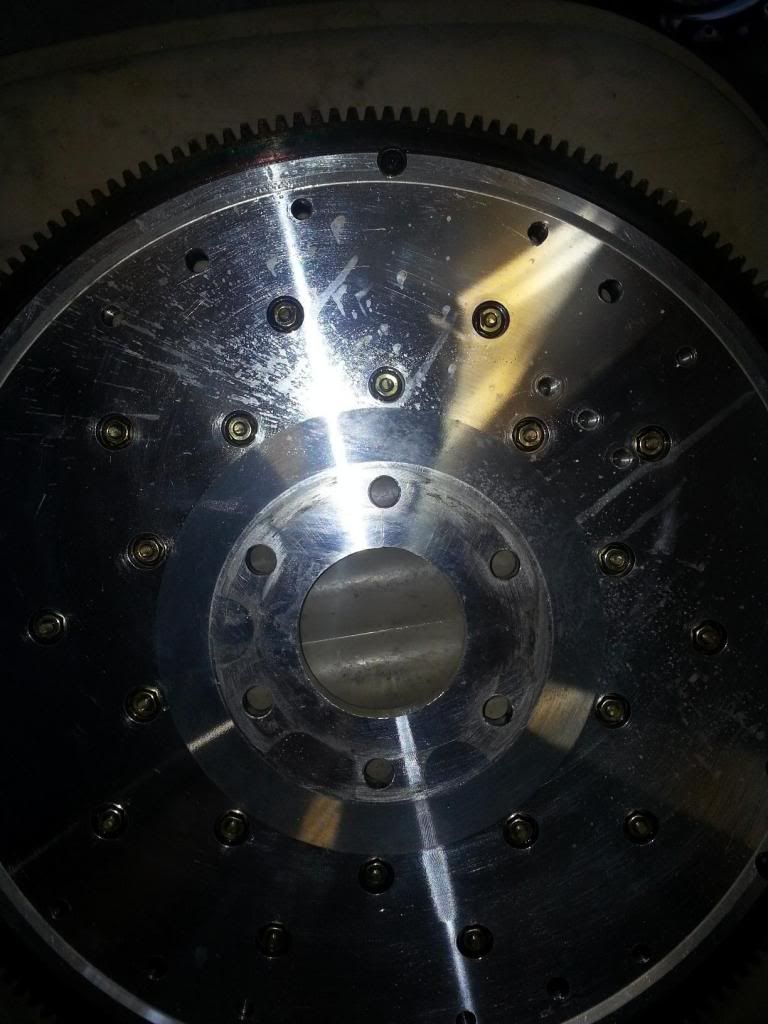

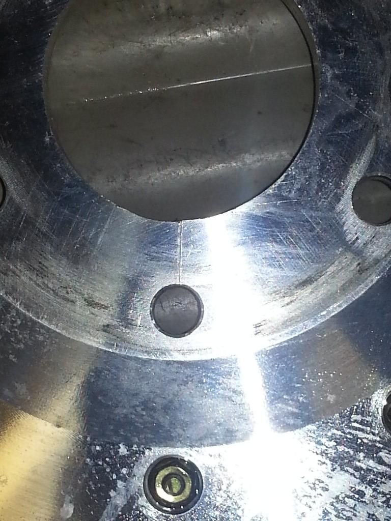

Now the flywheel.  Having never cracked one before I wasn't sure what I was looking for so I took it outside and cleaned it.  Low and behold what did I find, but a crack that would at least explain why it's loose in the crank all of the sudden.  However the crack doesn't seem to all the way out the FW, it looks like it's only at the crank/bolt area.  For you guys who've seen this, does it look like this could be my noise problem?  Here are a couple of pics:
Re: Bang! Bang! Bang! Bang! Bang!
« Reply #10 on: July 23, 2013, 10:13:34 PM »
Don't know if that's the noise problem or not, but for SURE you need a new flywheel, Steve.  And if that crack was causing the flywheel to flex who knows what could be happening.  I had a pressure plate once where the bolts holding it to the flywheel were coming loose, and the bolts on the back of the pressure plate that held the release levers in place started hitting on the inside of the bellhousing.  Made a godawful racket.  You don't by chance see any witness marks inside the bellhousing do you?

Not sure either how that could be the cause of the noise but hey, it's not everyday one sees a cracked flywheel w/o a major blowup. Lucky, I guess.
Looks like the i.d. of flywheel crank flange was too tight (you mentioned it was a chore to take on and off) and the 'wheel wasn't seated 100% before the crank bolts were tightened. Could be a material flaw but I'll venture that when you had to draw-up the crank bolts with your torque wrench it clicked out before the 'wheel was fully seated. Would like to know the dimensions of flange i.d. versus the crank's o.d.  2X as well to closely checking both sides of the engine's thrust bearing for unusual wear.

Right about now, I'd say that noise was a blessing! That flywheel was major damage just waiting to happen! I'd be looking real close inside that bellhousing too. Things can get pretty tight in there.

The flywheel is a fidanza and the bell is a quicktime.  Other than that small visible crack there is nothing indicating a problem.  The pilot bearing is perfect and smooth in operation and both side of the thrust bearing are good.
