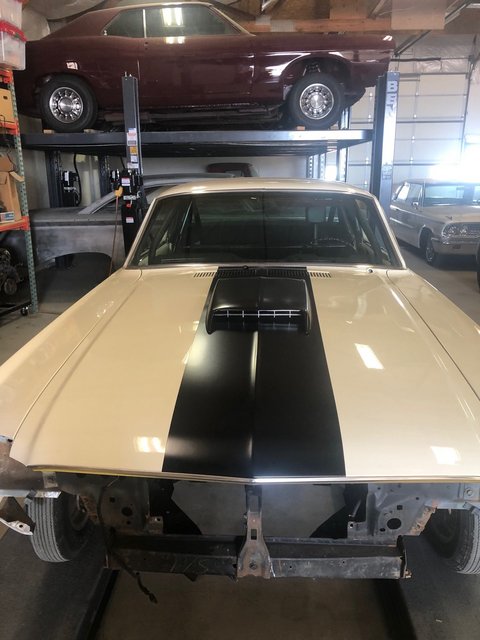

Lucky for you, I did some of this research recently as well.
Not sure if you have noticed this yet or not, but the stripe is not actually straight. It's wider in the rear than front. This is because the fenders are wider in the rear and if the stripe didn't widen it would create the illusion that the stripe was getting skinnier as it went back.
I looked at detailed pictures of some cobra jet Fords. What I found is the stripe covers 13 of the cowl fins from the middle on each side in the rear. So if you count out 13 fins and make your stripe end just outside of those. The front dimension is 15-1/2" wide. Rear will be close to 17-3/8" if you count out those fins.
This picture shows the scoop with the front grille in it, a local guy helped me realize that it shouldn't be in there so it's since been removed.
