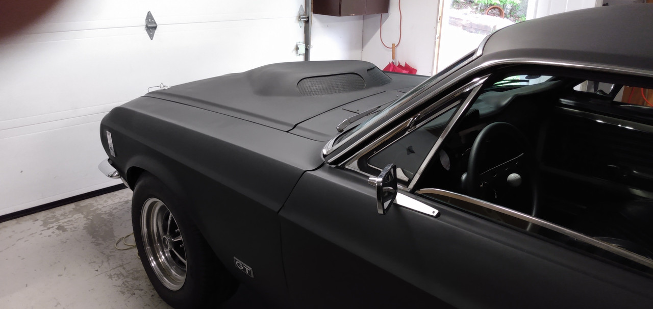

Tunnelwedge
  • Posts: 275
Re: top speed estimate
« Reply #24 on: November 01, 2023, 06:34:39 PM »
I put these covers on the cowl to stop the air from coming in.
This car is very fast on the highway.
