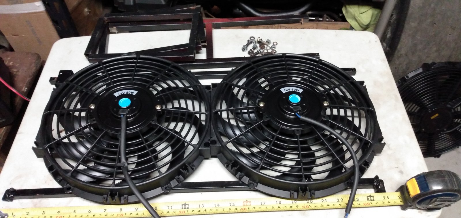

Amazon, they came early again.
The fans look great. I could not find any markings on the fans other than the stickers.
They do not have made in china on them so I'm happy.
I tested them and they both work and seem to pull a lot of air.
I will make up a bracket using my available junk.

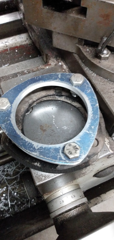

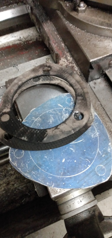

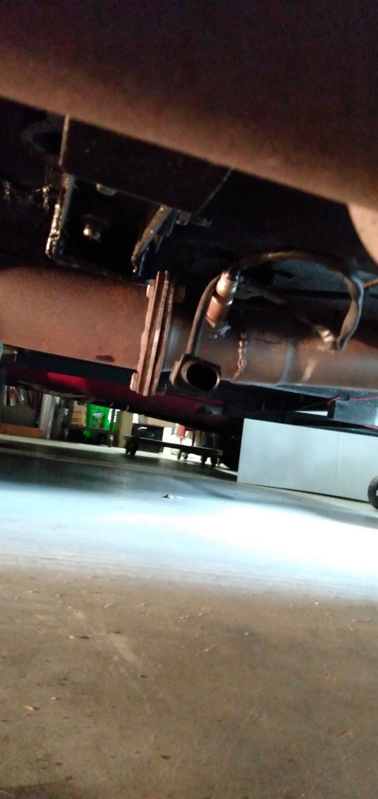

To put the Air Fuel Gauge in I had to take the pipes off.
So I started it without the pipes. ::)
https://www.youtube.com/watch?v=LbgTW8R-s08
I made some aluminum gaskets for the collectors and got the pipes back in with the O2 sensor installed.
Fans next.

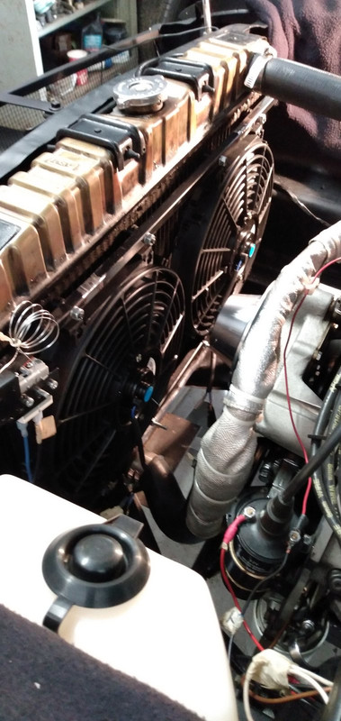

« Reply #22 on: October 12, 2023, 02:03:18 PM »
I have the fans hanging in place now.
I have them as close to the fins as possible with out them touching the fins.
Wiring next.

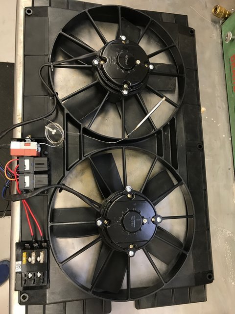

That looks alot like the stock radiator in my '66 Galaxie.  I was happy with a fan Ford has for the newer Mustangs as shown here.  A bit pricy but a very nice unit that needed very little work to fit the radiator.
Re: Radiators
« Reply #24 on: October 12, 2023, 10:17:27 PM »
Joe, this is the setup we run on the Cougar and on the 68 Mustang drag car. They put out a ton of air. I believe you can order this same setup without the fan relay kit, but the relay kit makes it easy to wire. On the cougar I relocated the relay to the bottom side of the shroud and you can't see it at all.
With both fans running this setup will sweep my barn floor for me.
https://www.stang-aholics.com/i-30750833-67-70-mustang-dual-electric-fans-with-shroud-and-wiring-for-24-inch-radiator.html

« Reply #25 on: October 12, 2023, 10:33:20 PM »
I don’t know how to put pics in but those are the fans that I have now Mike.. They work good just looking for a smidge more. Gonna go to the 12 inch setup. The more I think about it  my charging system could be the culprit. I think the fans slow up on longer rides. Sometimes after a long ride with fans on and I put on blinker my volt gauge rocks back and forth with the blinker. The car also doesn’t run as crisp. Yeah this winter gonna really go over the whole car. Everything’s been the same since it’s been together since 2013. What started this thread was the triple pass radiator that I saw, I guess nobody has gone down that rabbit hole so I will stick with a regular radiator.
