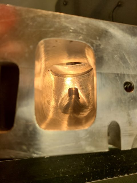

Our medium riser port design has been complete for over a year. The prototype MR head started as an Edelbrock Pro-Port casting. During porting material was actually added in the port to make it flow correctly, which meant this definitely couldn't be made as a pro-port CNC head, it would have to be a new casting. My brother, Dave Bamber, is responsible for all the flow work on this port design. Here is an idea of how the MR head flows and what it looks like:

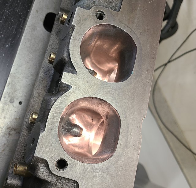

The TP development started by optimizing a factory cast iron head so we could digitize and apply it to the computer model. Hours and hours were spent on the flow bench. Some real nice flow numbers were achieved on the intake ports. The port was digitized and copied on all other cylinders. We had fully intended on dyno testing with this intake port design but as you’ll see in the pictures, when CNC’d, one of the eight intake ports found a water jacket (core shift in the head).

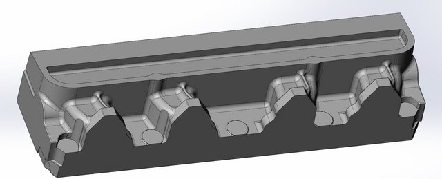

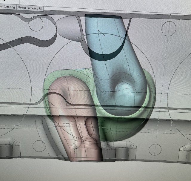

Here are screenshots of some of the computer modeling that has been done on the heads.
Patterns and molds are finally progressing and we can now see light at the end of the tunnel. When these are available, they will be cast/machined by me (Bamber Engineering) and sold through Brunson Performance. We will post more technical info/graphs/test data on their website soon.
