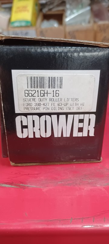

« Reply #10 on: July 02, 2023, 02:11:04 PM »
Not having any luck so far on lifter part number, maybe this pic will help.
Found what at I think is the pushrod length @ 9.062 - does that even sound in the ballpark?
Most of these parts are Circa 2005/2008 IIRC

« Reply #11 on: July 03, 2023, 11:16:44 AM »
These are the FE specific lifters with pin oiling:
My pushrods are 8.980" effective length, but there are so many variables- deck height, head gasket thickness, which heads and if milled or not, rocker brand/stand height, adjuster brand and placement, cam base circle diameter, etc. Yours are prolly close. For instance, my heads have been milled to death, so shorter pushrods.

What's the part number on the lifters?
Crower 66216H-16
Also Springs are Crower 68385X2-16 = 432 lbs./in.
The cam part number is Crower 16462.
