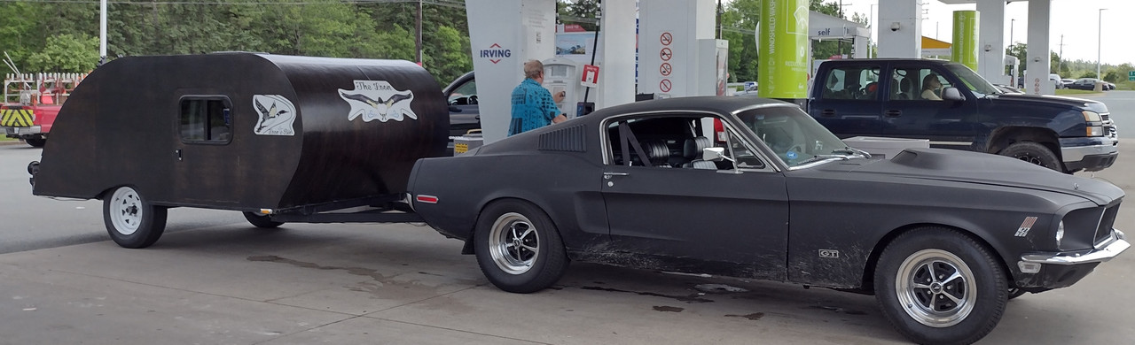

My cheap ass 650's. Work great.
It runs on the front carb until about 3300 rpm
then the back carb will start to open. I have worked the transition slot and timing.
In 4th I'm legally speeding on any public highway @3200 rpm. Which would be illegal.
It gets ok mileage. The trailer put a dent in that. I was stopping all the time.
I have a stock gas tank. A bigger tank would make difference.
I have about 11.5 of vac @ idle. I can run it on 87 if I have to. And I have.
It's a highway engine and car. No electronics on the engine.
I don't use a choke on either carb and I have no problem starting it on cool wet morning.
I think if you have the coin and like the look those on top of TW with some nicely done
plumbing/wiring. And well done linkage and a nice gas tank to go with it.
That would be a really nice show piece.
Depending how you use the TW and the type of engine under it will be part of the equation.
