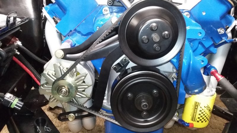

I converted my '66 Galaxie (390 high mount alternator) to the 3G not long ago.  Upgraded the stator and rectifier to bump it to 240 amp output and converted to serpentine belt as well.  You can keep the original pulleys if you want, but I didn't think a single V-belt would handle the stress if the alternator was under a heavy load.  Motortrend had an excellent write up about this conversion back in 2019.  https://www.motortrend.com/how-to/install-high-output-ford-3g-alternator-older-fords  Please ignore the rats nest of wiring.  I'm currently in the middle of switching to an electric fan for the radiator which led me into the alternator upgrade.   ;D
