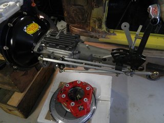

Tunnelwedge
  • Posts: 275
Re: transmission options
« Reply #5 on: April 30, 2023, 02:07:00 PM »
You want to avoid the DR4, which is the older Jerico that is no longer supported by them. There are quite a few parts out there for them, but you have to search and hope you get lucky. The DR4-4 is the newer design that they have, and supply parts for. And yes, it's really stupid of them not to support the older version. They basically gave a giant middle finger to anyone who bought their older design. NOT a good business practice.
do they at least offer a discount for people who have bought a new dr4 transmission in the past? is the dr4-4 really that much better?
In my experience, yes the DR4-4 is a much better gear box.
My really old DR4

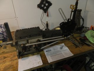

My homemade DR4-4

    Tunnel port,could you explain what "home made" means? A conversion of sorts?
Tunnelwedge
  • Posts: 275
« Reply #7 on: April 30, 2023, 05:17:18 PM »
          Thanks Doug, with out asking I would have bought the DR4 not knowing better.
Home made. I built it on my work bench. I used a Roush case and a stock Jerico 26 spline input shaft and 32 spline output shaft.
Used a mix of Jerico and Emco gears. Used star dogs and a few home made things for it.
Work great. Excellent shifts and you could down shift and street drive it.
If I was going to buy another gear box though, I would get a TKX. ;)
