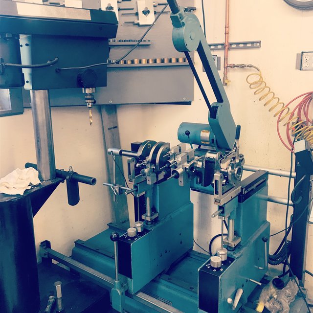

I went through my pictures and found one when I was balancing the 4.25" crank for my 428 stroker engine. Hopefully this gives you an idea of what your engine will likely need (being that it's also a 428 stroker engine).
I didn't take any pictures of the drilling operation, but the yellow marker in the picture show where the heavy metal was needed. One piece was put in this location, and then a small hole was drilled in the top of the counterweight to get the balance trimmed back into spec, because we slightly overshoot when placing the heavy metal.
If your situation is similar to this one, which I think it likely will be, only 1 hole will need to be drilled in the top of the counterweight if balanced carefully. You wont have to worry about "swiss cheese".
