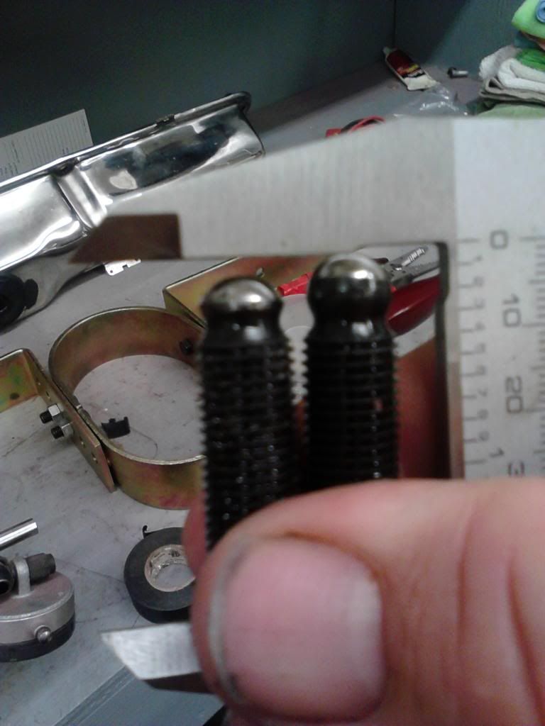

We took the car out cruising and I noticed my lifters /rockers had gained some noise ! My heart dropped and I put the car away and for the rest of the week. I have been crying about losing my cam and needing to redo my motor ! I took the valve cover off and my heart sank as I now have 60 tho under one rocker ! just then I noticed there was no ball showing out of the pushrod ! :o  SO after tearing them all off I have one rocker that wore the ball in half ! all the rest look perfect and measured out good.  WHY ? seems to be getting oil (not blued) no dings or scratches on pushrod from intake, pushrod not bent, bad luck ? defect? replace it and move on ?  scary sheet ..... I can take a pic if it would be helpful ...... HELP !

Might be just the rocker adjuster.  I've heard of cases where they are not hardened properly and will wear.  How does the pushrod look?

Bad adjuster is my guess.  Heat treat was probably too shallow - once you wear past the outer layer you're into soft metal and it'll wear off pretty fast.  They cannot harden an adjuster through because the threaded portion would become too brittle, so they just get a case hardening or they mask the threads with copper plate.

Your picture got me thinking. I went out and dug out my Comp/Dove setup, After looking at the adjusters they all look like your bad one, I believe they are made that way, mine are not worn like yours but are not a full "ball" either. I can see where they would be of concern.

Are yours used? Because that is not normal. They should all be round like the good one shown, regardless of maker....unless they have a TON of miles on them.
Bartlett, I would flush that engine down good. Very good. You will want to get all the worn metal particles out. In fact, if it were me, I'd change the filter and oil, run it with the new parts, and then change it again after an hour or two running. Better safe than sorry.
