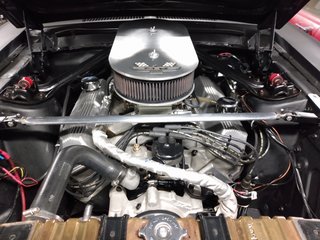

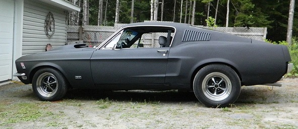

My Fastback 427 Stroker, 482 ci, 4 speed.
Genesis Block, Scat Crank, BBM Heads. Factory Tunnelwedge intake.
Wide ratio Top Loader. 3.50 gears.
Street driven. Runs great. Anything above 2000 rpm.
It could be worse, I could restore the car and it would be
a Dynacorn body with a 289 and C4. Probably worth more though. ;D

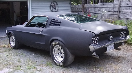

« Reply #3 on: April 16, 2023, 07:20:47 PM »
With the ProStars.

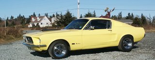

« Reply #6 on: April 19, 2023, 05:54:58 AM »
At the Moose. ::)

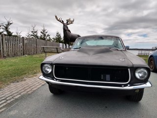

« Reply #7 on: April 19, 2023, 08:33:12 AM »
At the moose awhile back.

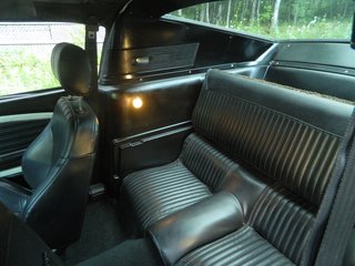

« Reply #8 on: May 27, 2023, 05:34:49 AM »

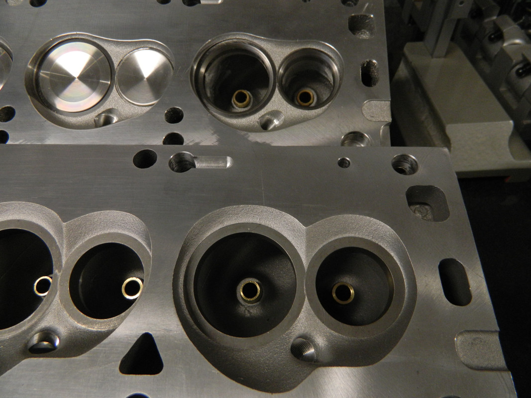

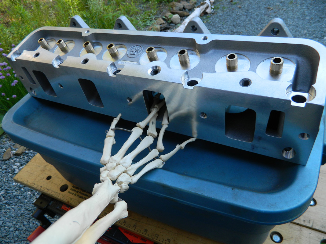

The working side of the BBM heads.
I purchased the heads with no valves.
I purchased some REV valves and cut the seats on my First mill.
I did a 45* seat and a 60* and 30* relief.
I always wanted to do my own heads. ::)
They seem to work. Compared to the ED head, they look better I think. ;D
« Last Edit: May 27, 2023, 05:48:08 AM by Tunnelwedge »
