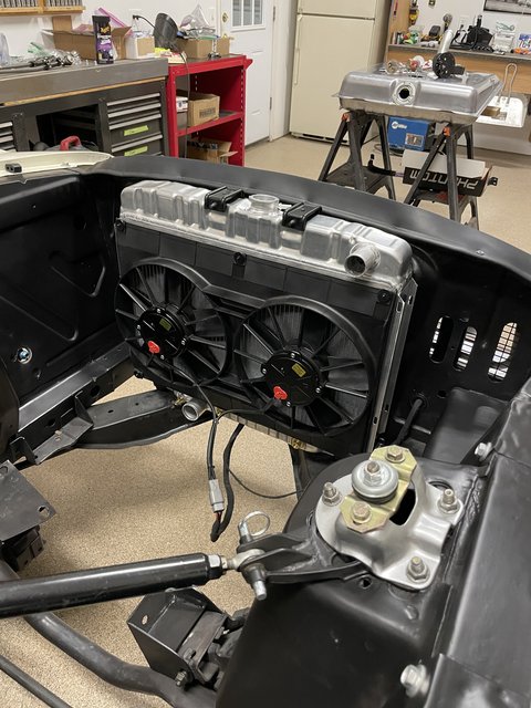

I use the same radiator that Jay is using.  It has a set of Camaro LT1 fans mounted on it - they fit perfectly and replacement motors are available because they are an OEM item.
I can tell you that with a 500 HP iron headed 351C on the street, the best temp control was had using a 195F thermostat.  I believe I had the fans triggered one at 190F, off at 180.  This setup controlled temp including in summer here, where the asphalt will be 130~150F in the afternoon.  And, on the track where we have seen starting line temps of 160F.  The current setup is set for 180 on, 170 off but I currently use just the manual override with the control disconnected.  I don't run the fans going down the track.
Another Note:
Note the flaps on the upper left/lower right (Got to fix that missing flap LOL).  Those flaps are there to bypass air when the car is moving.  Most of the aftermarket setups do not have this.  I mention this because at a certain speed (unknown, but easily before highway speed) electric fans become more cardboard disk than fan.  In other words - they become a blockage to air passing through the radiator.  Hence the OEM fan support using bleed off ports.  That Maradyne fan unit seems to have those.  "Take care to notice that the assembly has a top and bottom orientation where the air vent doors hang down."
« Last Edit: August 30, 2022, 03:47:54 PM by Falcon67 »

« Reply #21 on: August 30, 2022, 04:10:45 PM »
So Falcon 67 I would assume your frame is notched both sides. How far out does the fans stick out looks alittle far but I bet they move some air though.
I will research those fans mike. They look good, CFM wise also.
« Last Edit: August 30, 2022, 04:14:18 PM by Stangman »

« Reply #22 on: August 31, 2022, 10:35:57 AM »
In a Fairlane chassis, not required.  Falcon/Fairlane same engine compartment.  The combo sits right on the forward strut rod braces and top is just about level with the radiator support.  Note that for ease of service, the top of the rad support has been removed (easier engine extraction).  Also, the core support "window" has been opened up to accommodate the larger core area.
If I were to drop that in the (gone now) 70 Mustang, yes - have to notch or ? the frame because it's too wide for the Mustang nose.  IIRC only a 26" wide generic 2 core aluminum will fit between the frame rails on a Mustang.

« Reply #23 on: August 31, 2022, 11:18:55 AM »
Wow didn’t realize the falcon was as wide. Definetly going to save up for this.

Jay do you use a shroud assembly our do you mount them to the radiator with those zip tie things. I wound like to get 2 13 inch fans but I dont know if they would fit or did you make a shroud for it. What size fans are on it. I thought about putting a 16 and a 10 even. And yes I heard that about the Spal fans. Oh and to let everyone know I called Spal for a 170 degree fan temp sensor and they told me to call American Volt company and I got it from them but they have a bunch of other stuff including Spal fans and they are like 30 percent cheaper than buying from somewher else. Jay a picture of your setup would be cool. No rush I cant get it for a few weks but would like to get everything together so I know
I can state that the 70 Mustang with two 13" fans individually mounted to a 26x19 aluminum 2 pass was barely sufficient for drags trip use with a 460 HP 351C.
Track cooling performance improved when I built a shroud to mount the fans, about a 1" deep item formed from .030 aluminum.  Note that this was still insufficient for any type of street use, primarily because the cheap eBay fans simply did not move enough air for the job IMHO.  But it was a race car, so street use was not a design criteria.
Note 19" tall unit vs the radiator support
« Last Edit: September 01, 2022, 11:05:55 AM by Falcon67 »
