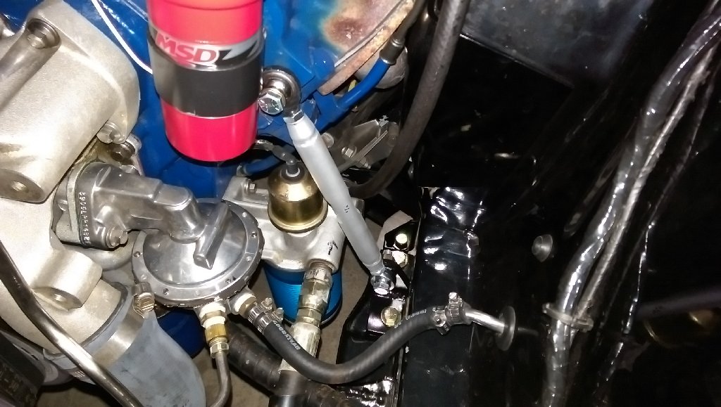

Yeah Doug , I was dreaming up some sort of small nylon bushed rod ends to do something similar . I think that would do wonders for the whole situation.. This engine going in there now is really just a temporary deal to get the whole combination worked out so I will get another chance at doing some small modifications when it comes out and before the big one goes in. Im glad you posted that pic  , I was convinced that these mounts set the engine a tad lower. Unless of course you have the same adjustable mounts on that one....
No, those are factory style mounts. I do have a set of the captured poly mounts that I'll be putting in with the new engine, along with the reinforced, heavy duty lower crossmember for improved rigidity. Hopefully those new mounts do not lower the engine. I've got a pretty good reference spot on the tower to let me know if anything has changed (in other words, peck marks on the tower braces...lol). I've done pretty much the same thing as you; starting out mildly stock/modified, ramping it up as I've gone, with bigger changes coming soon.
You can shim the engine up a little, by elongating certain holes and using spacers or washers. The only drawback to that is the already tight clearance to the hood, and changing driveline angle, both of which can be addressed if you're anticipating the issue.

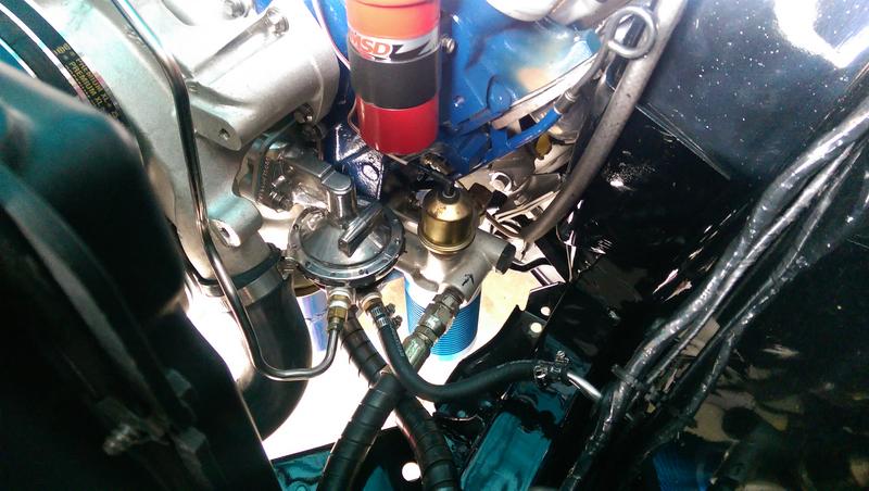

And you show the precise reason why I don't like pentroof style covers in a Mustang. They just take up way too much valuable space and cause interference issues. Not to mention they make getting your hand in certain places pretty much impossible.
