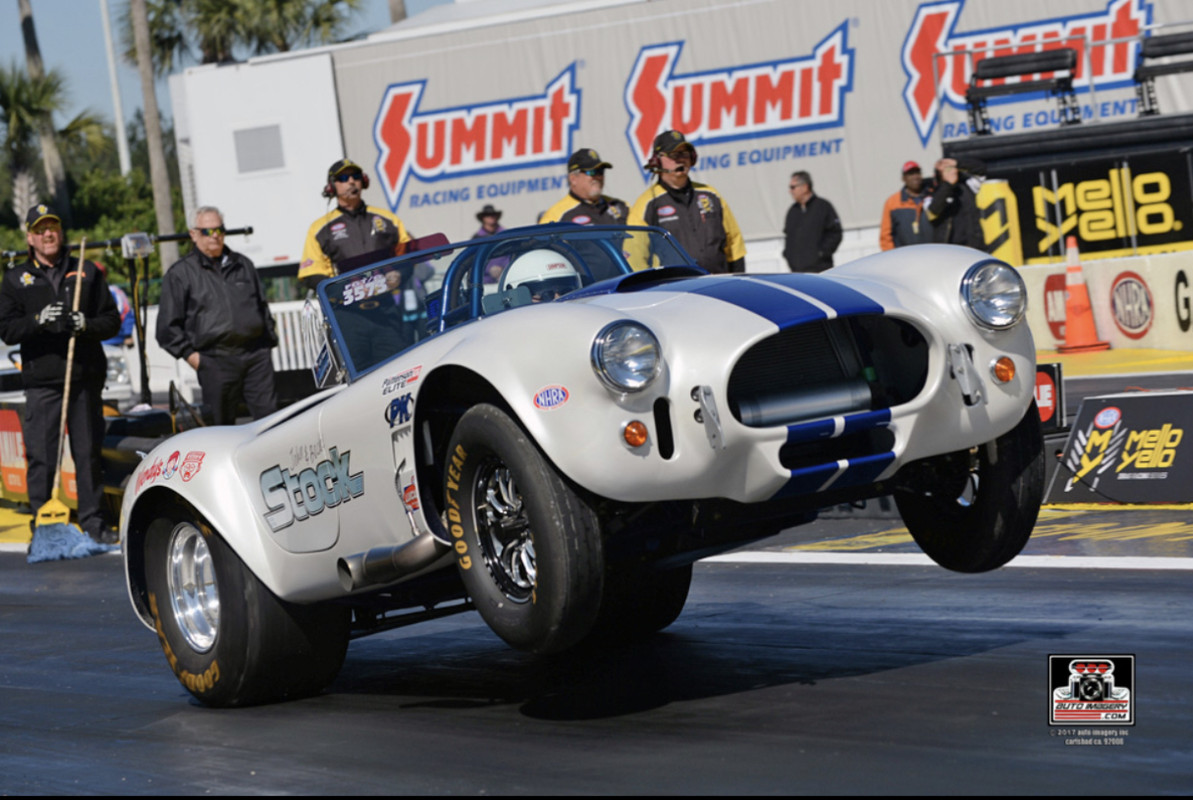

Currently, the only Cobra I'm aware of that is running NHRA SuperStock and SS/GT belongs to John Stock, based out of Ohio and his cage/roll bar resembles a funny car-type enclosure around the driver's upper body. I believe John's car is a Kirkham, prepared for NHRA racing by Pat and Andy Kronenbitter of PK Race Cars, based near Columbus, OH.

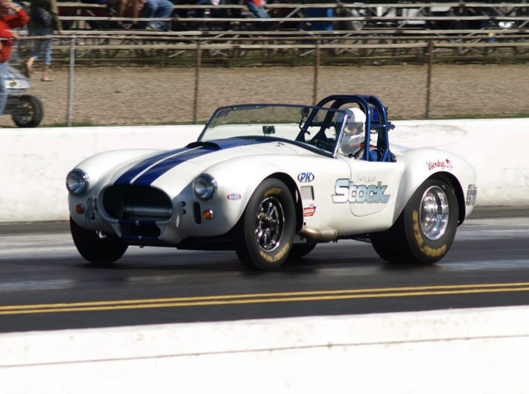

I’m not sure exactly what type of roll cage you are looking to build. Left hand drive open top roadsters of various body types are very common in the NHRA Super Gas category, for example. But they of course generally run a complete fabricated chassis. We have a local Minnesota racer and race car builder who has a Cobra replica bodied Super Gas car, although I couldn’t turn up a picture with a quick search, I’ll keep trying. As mentioned by SSdynosaur, John Stock runs a Cobra in NHRA Super Stock, and my understanding is the same, it’s based on a Kirkham body & chassis. Here’s a picture from the Internet of John’s car. A few years back, one of the years I ran Hot Rod Drag Week, there was a competitor running a Cobra replica, with just the typical Cobra style hoop roll bar, and they were allowed to run, but I don’t know what ET they were tech’s for.
Cool car and great pics!

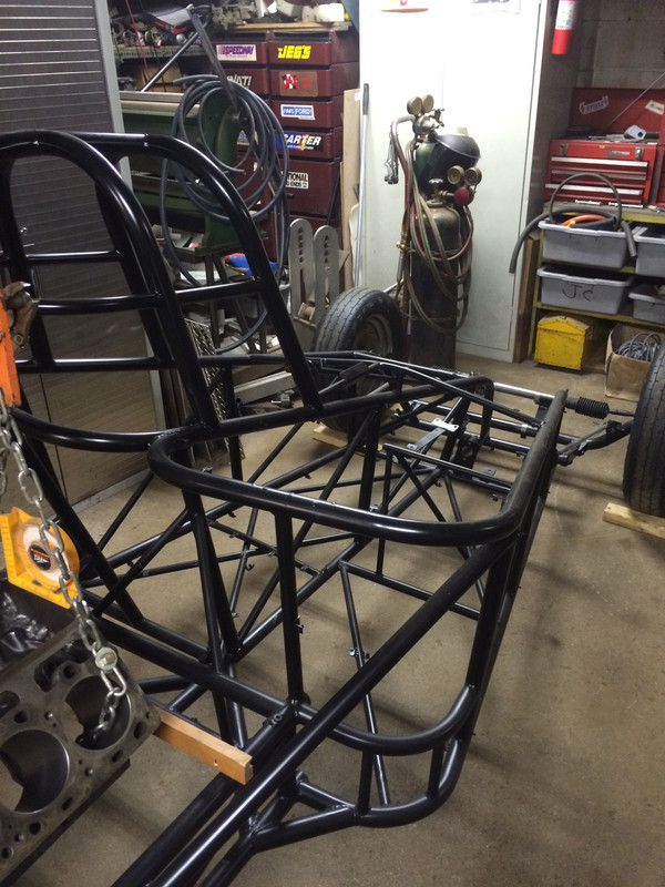

Another one of our local friends, JC, wanted to build a two seat, side by side, rear engine dragster. The idea was to build something he could run at the track, driver only of course, but also put another seat in and use at fairgrounds cruise events, and have a passenger. He wanted it to be NHRA legal, although I don’t believe he’s ever bothered to get the chassis sticker. He sent away for the SFI specs to build it to a NHRA legal spec. If I remember it was an involved process to get SFI to get him the proper blueprints, since what he wanted to build wasn’t “normal”. But in the end it was possible, and he built it. Here’s a picture below from when he was building it, and without the body work. Even though it is a rear engine configuration maybe that will help give you some ideas for the cockpit? As far as what’s in the NHRA rulebook, I think NHRA now days is figuring if you’re building a cage or chassis beyond something basic you will send away to SFI for the blueprints.

The John Stock cage and the one for the two seater are basically the same as most dragster cages around the driver.  Pretty much identical to my dragster cage.  Whichever, you'll want to allow 1~2" wider than your shoulders for fit.  If it's run down to the frame/lower rails like most others, consider "pull up" lap belts vs the "pull down" style, much, much easier to hook up and cinch.
