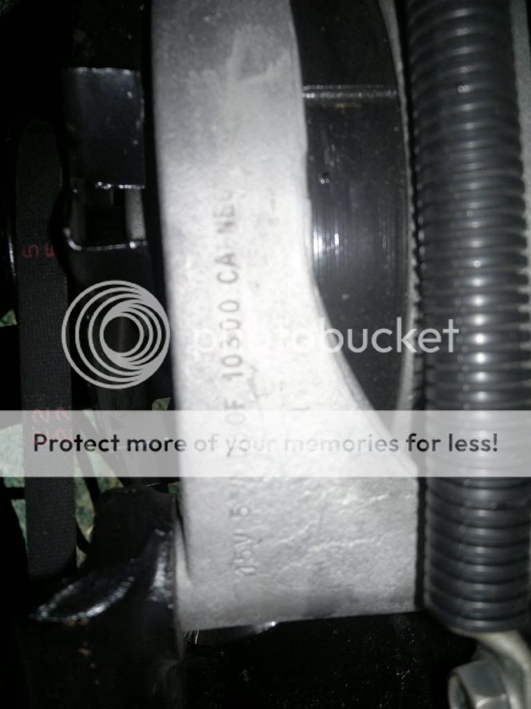

Thanks Ross. Will give it a go. Put the old regulator back on today and all seemed fine. Opened the new one and it has two coils in it like the old one. Just underneath it doesn't have as many as those weird looking coily things.
Couple of pics for the hell of it.
