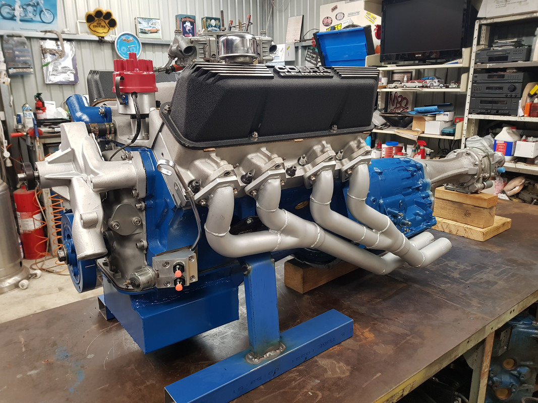

what is the longest time that any of you let a new engine sit that was built before it was started?

built the engine for my cobra with bbm block and heads all new parts but then left for england for 2 years. motor has sat for 3 years hand turned by my brother while i was away. plan on priming it was well lubed while assembled, just a little worried about how long it sat,
