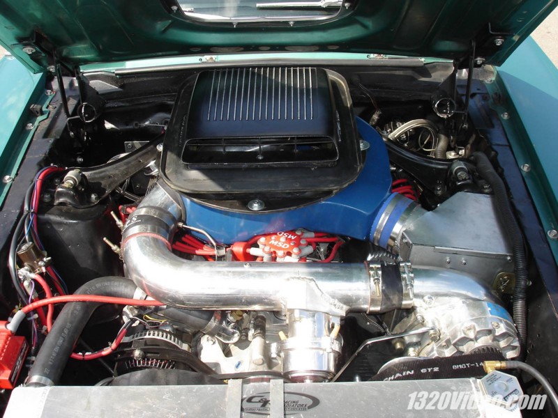

I used some Weld 15x8s on the 70 with 4.5" backspace and they kept the 28" 10" tread Hoosier slicks inside the fenders and clear of the leaf springs.  Same tire as a 275-60x15 drag radial. Fronts were just Weld 3.5 or 4.5" units with 28" front runners, I forget which width.  Car long gone now.  Flacon runs similar back wheel - 15x8 Ansen 4.5" backspace with a 275-60x15 Hoosier drag radial.
How that looks in the fenderwell:
