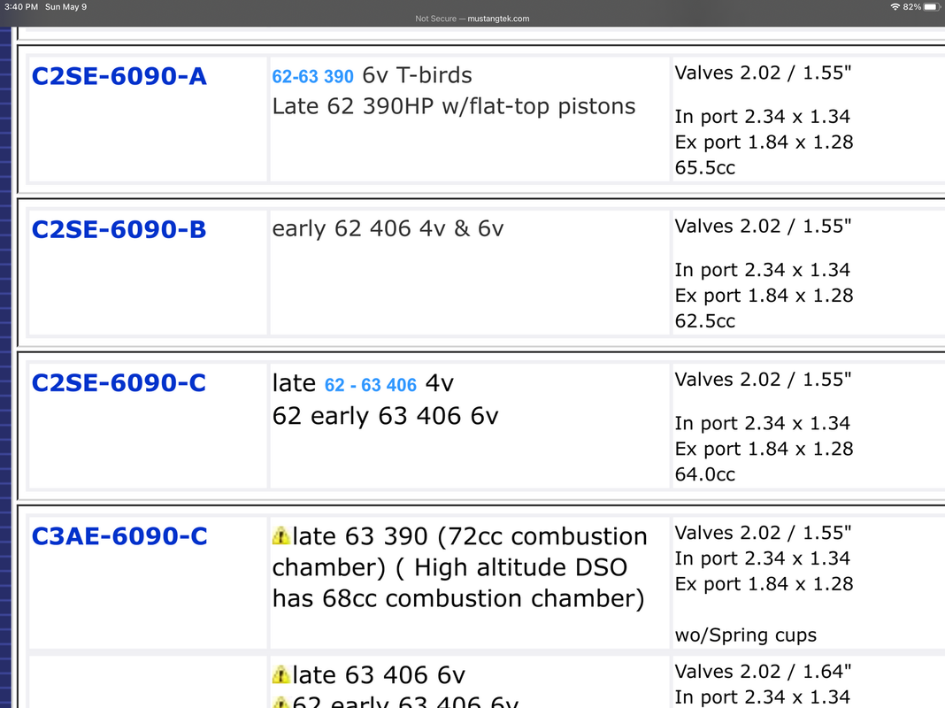

Re: Fe Engine
« Reply #6 on: May 09, 2021, 05:46:01 PM »
Off of Mustang Tek

Re: Fe Engine
« Reply #9 on: May 10, 2021, 10:14:32 AM »
As for Mustang Tek, it's often wrong.
Please tell us where so we all know.
FE4SPDMustang
Re: Fe Engine
« Reply #10 on: May 10, 2021, 04:16:56 PM »
Several applications are speculative.

FE4SPDMustang
Re: Fe Engine
« Reply #14 on: May 10, 2021, 07:23:04 PM »
No, FORD did this. It's commonly known about the C2SE-C heads and well as the '68 N heads. They also came with and without 427 style spring seats.
These were in the Ford box and wrap, stapled shut. I bought them with NOS 2.09 and 1.66 valves in the boxes, 427 springs and seats. The heads were cut for the spring seats. It's not a fairy tale like the 68' 427 W code Mustang.  As a matter of fact I sold them to Ben from the 332-428 FE Forum.
They're a great head except the tiny 62CC chamber and they are horrible to deal with in a tower car with headers.
