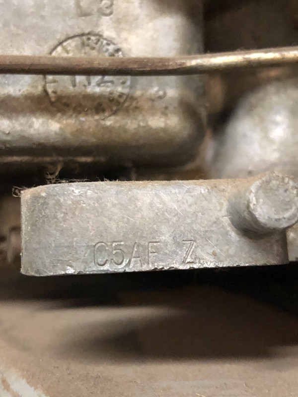

65 is too new for my parts books  lol   Carb is C5AF and the rest is mangled..  If you could look when you get a chance I would appreciate it
Well, that narrows it down to about 3 dozen possibilities lol. Is it a “1.12” carb? Just making sure. Are you sure there isn’t anything readable here? Just trying to get you the most accurate info.

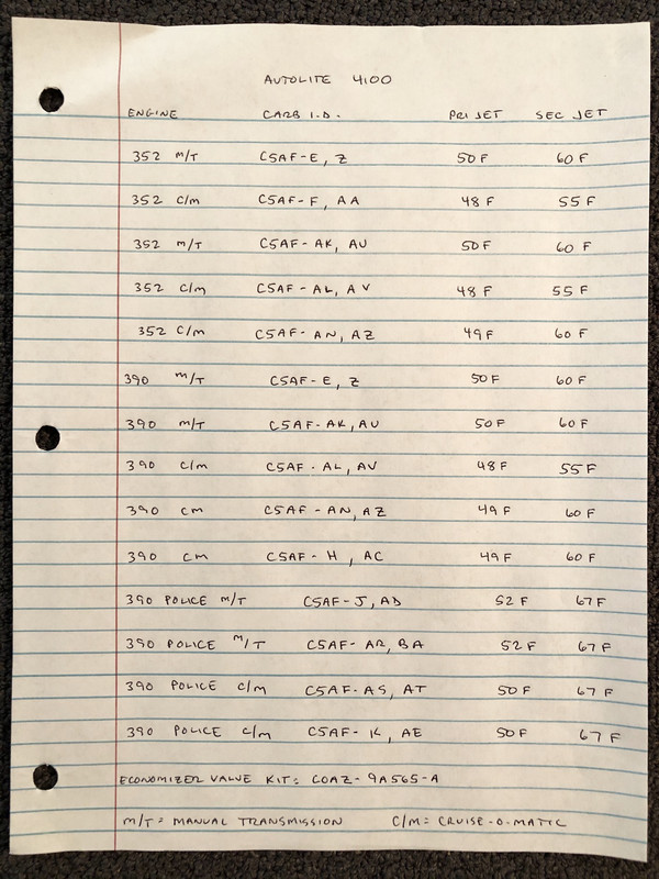

  • Posts: 1966
Re: Autolite Jetting
« Reply #13 on: May 06, 2021, 12:37:12 PM »
Royce, I made you out a chart for the C5AF-xx 352 & 390 Ford 4 bbl carb jetting. I included the 390’s just because they’re similar and have some application overlap, but the info for the 390 Police Interceptor ones is interesting also. This is for 0-5,000 ft elevations, which would be stock. The Ford Parts Book just lists the jet number & part number, it doesn’t include the actual orifice measurement, I’m guessing that info exists somewhere, but I don’t remember seeing it. For the Economizer valve ( power valve ) it looks like they all take “kit” part number C0AZ-9A565-A. That’s for elevations from 0-5,000 ft. The “kit” includes the valve and two different gaskets. There are a couple different kits for higher elevations. I don’t know off hand what that valve equates to for a vacuum rating like a Holley power valve. At least without testing a stock one. Most people I know that race with a 4100 substitute a Holley power valve to get the variety. With those Jet part numbers on the other page I pictured you can often find NOS ones, and someone has been making reproduction Ford “F” Jets in various sizes, I’ve seen them on eBay before. Possibly available from some of the bigger carb parts suppliers too.
