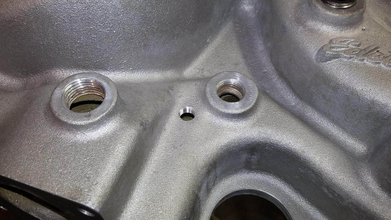

Doug, I'm not sure which style of gauges you currently have and if you're willing to spend the extra money for it, but I went the electric route for water temp and fuel pressure. I have the AutoMeter Ultra Lite II 2 5/8" gauges. Anyhow, the sending unit is 1/8" NPT. I didn't want to piggy back fittings, so I decided to drill and tap my RPM intake for the added sensor, since I also have a heater fitting in use and another for the electric fan sensor. I used my sonic checker to find a safe location and where it was accessible to tighten/loosen the fitting. IIRC, the thickness was around .240" and seemed like plenty of thread engagement for 1/8" NPT. I decided on here:
Re: How to create a new port for temp gauge probe? Using a Sniper t-stat
« Reply #3 on: August 19, 2020, 07:32:42 AM »
« Reply #4 on: August 19, 2020, 07:38:58 AM »
