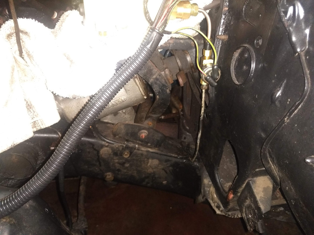

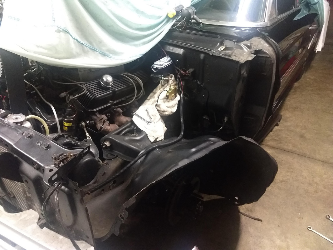

Well, it's taken a few weeks to finally get back on this project.   Had quite the deal to work through last night just to get the rear brake line attached to the proportioning valve.  Ugh.
Had to pull the drivers fender to get the inner fender out of the way.  That of course meant I had to remove the grille, headlight bucket and drop the front bumper.  Geez o pete.  This thing better stop on a dime and spit out 8 cents change!!!
Shortened the original line about 3" and reflared it.
I got the master cylinder bled and the lines attached.  I seem to have a leaker on the PV?  Going to have to pull that little line and inspect the flare.  I'm going to get everything bled up before I go through all the work of getting the front end back on.  I'm not pulling all this crap again!!  I only knicked the edge of the door a couple times getting the fender out.  Glad it's black and easy to dab some touch up on the corner.  Not the first time it's gotten some rash on it during the last 22 yrs since it was painted.
