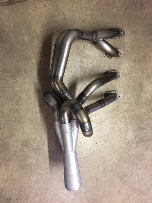

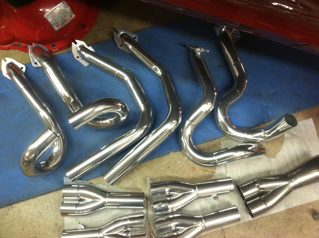

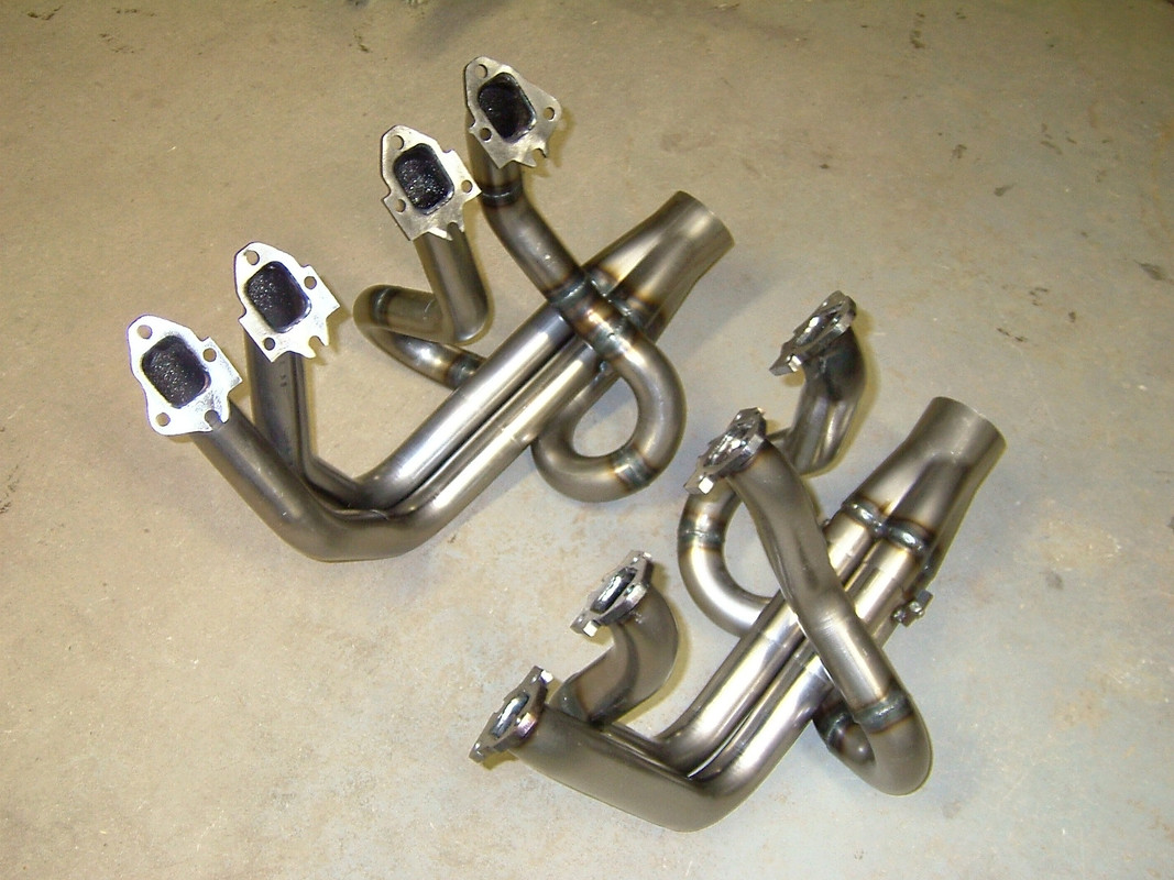

I have smashed a few sets of headers myself. Hookers and Mad Dogs are very similar in design and ground clearance. The set of Mad Dogs I bought were custom... I talked him into doing a set of 2 to 2 1/8" step headers. He was reluctant at first, but did do them. I told him I would pay the same amount and that I didn't need any collectors, he agreed. It took a while but they did show up. I have Blue Thunder heads, with the .400 raised exhaust flange and notched shock towers, so was a bit "tighter" fitting, but able to run the Hookers before. The Mad Dog were close, but I think he messed up on at least one tube. No way it was going to fit. I had to cut it and buy a J-bend and change it around some and re-weld it. I modified one other tube slightly. I bought them raw, and after fitting them, had them coated. I think I paid 675 for the headers, and 400 to have them coated including my 4-2-1 collectors, well the 2-1 were already coated so I didn't do those. Definitely less money than Hookers or REF. They worked fine and made good power, until I did a huge wheelie and smashed them on the landing. I tried a set of REF and they didn't fit either. I have a set of 2 1/8" hookers on for the moment, but will be switching back to the REF after I make a new #8 and modify the #4, they do have way more ground clearance.
Here is a file photo from Mad Dog, although these are not step, it is the same header design (like Hooker).
Here they are after coating, laid out, separate.
Here are the REF

Thor, thanks for that excellent post. What was the issue with the REF's? Number 8 looks like it had something to do with the linkage or frame rail, judging by the picture. Was #4 the starter or frame rail? Having to modify a tube or 2 would be fine with me, and gaining ground clearance is pretty valuable. I've switched my thinking to getting raw and fitting them before coating.
Those Mad Dog headers do look like a pretty good alternative to the Hookers.
