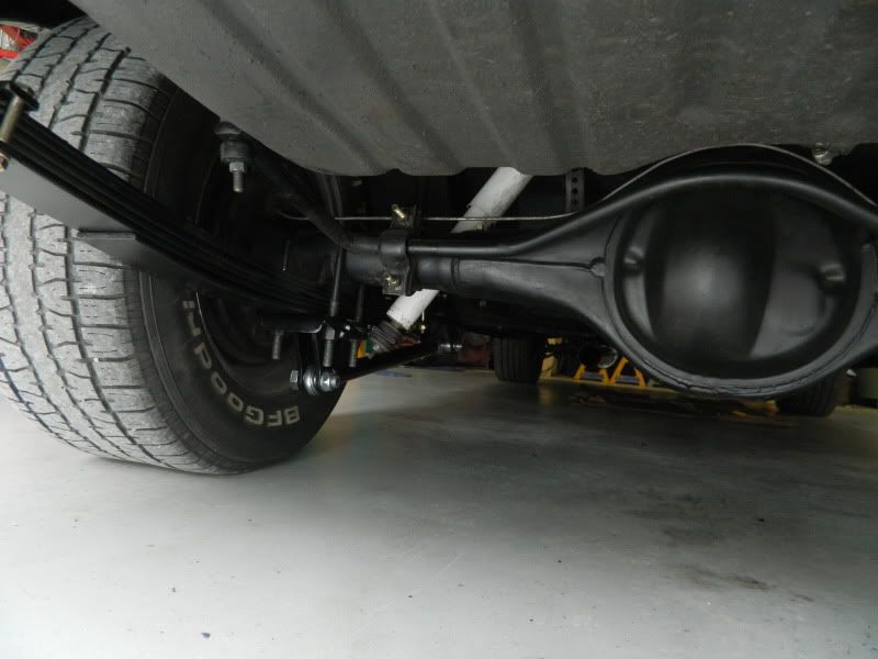

My all custom Currie Heavy Duty Big Bearing 67 Fairlane setup.
No traction with the BFG`s but the rest of the gear works great.  ::)
