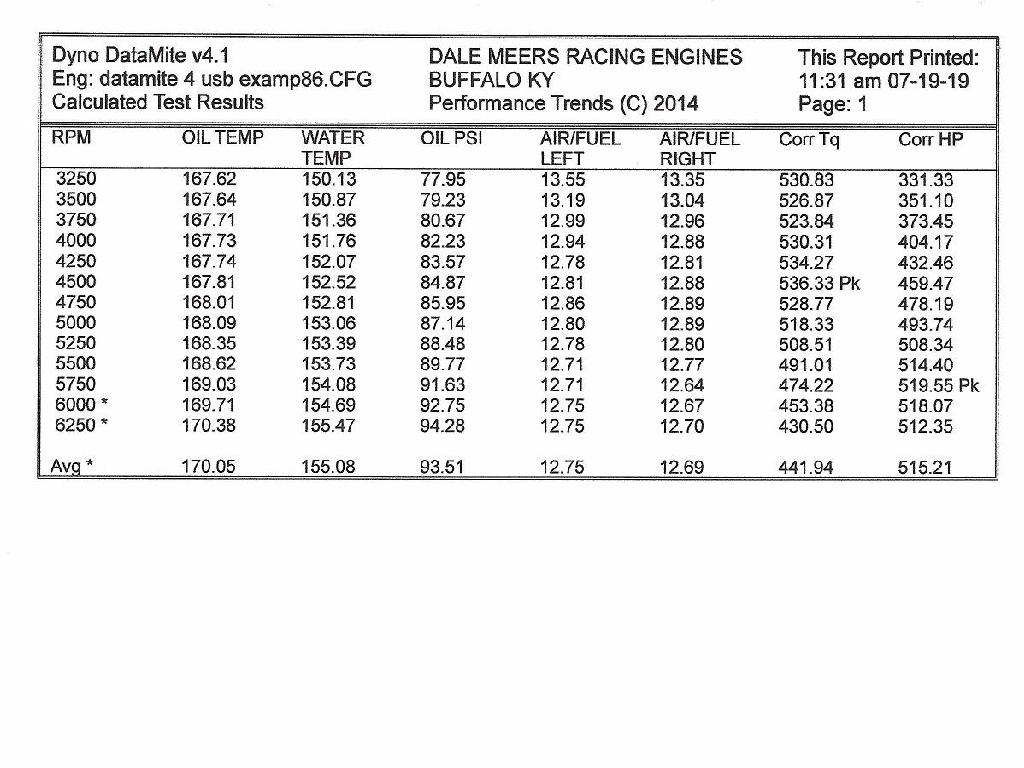

  • Posts: 4202
rockhouse66
  • Posts: 273
Geez!  You must be losing 10 HP driving the oil pump at those pressures!   ;)
Jim
67428GT500
  • Posts: 694
I see your HV pump was pulling over 80 lbs too. I thought there might be someting wrong with mine. It pulls almost what it did with the 427 pink spring change I had in the other. 100lbs cold.
