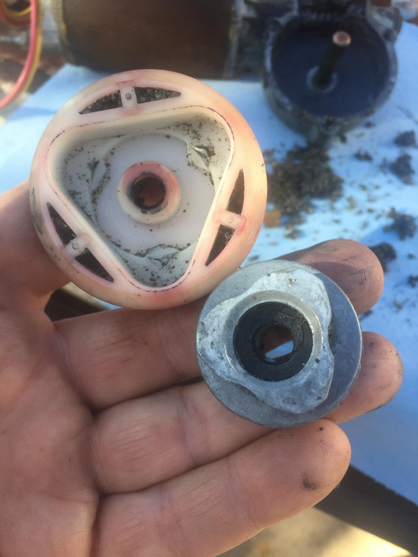

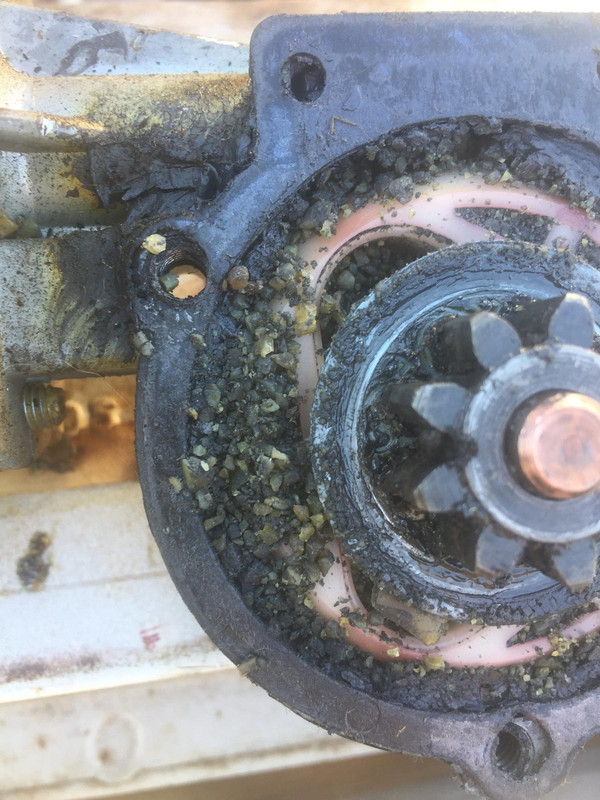

Thought you guys would enjoy a look at this.
My magic tailgate window stop going up and down. Took it apart this morning to see what was the matter. The motor drives a worm gear which in turn drives a plastic/nylon gear on a shaft that has an internal triangular chamber. In the chamber it looks like there was another triangle that takes up slack and drives the triangular bottom of the gear that drives the arms that role the window up and down.It looks like the intermediate plastic triangle got eaten up over the years and left its parts all over the insides of the assembly.
I think what I’ll do is head up to my friends shop and make a new intermediate triangle out of metal.
I’ll let you know how it turns out.
That is the most common failure of power windows. Motor is fine..everything else is fine, its just the clutching mechanism that goes south. I got some aluminum round stock and whittled out 3 tri-lobe 'cams' using a  hand file replacing the disintegrated nylon pieces.

« Reply #86 on: October 26, 2018, 08:23:09 PM »
Yeah that’s what I figured I would do.
It’s interesting to me that they would build it like that.

« Reply #87 on: November 30, 2018, 03:27:16 PM »
Well it was easier than I thought.
Found the easiest fix for he tailgate window motor.
Jeff’s Bronco Graveyard (and I’m sure others) sells bronco tail gate motor repair kits. The pattern for the mounting bolts are different but the internals are exactly the same. I was easily able to save my gasket and cover so I just installed the new gear prices and it runs like a top.
