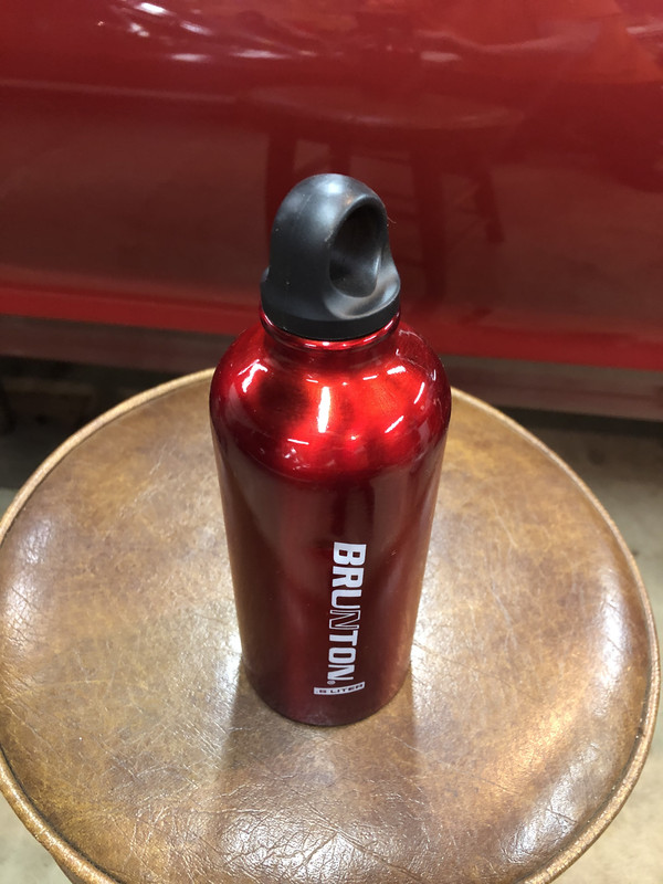

Before Drag Week 2015 I moved mine behind the passenger side headlight area, with a bracket to the side of the core support. I used one of those aluminum water bottles I got from the thrift store, turned upside down, so the threaded cap serves as the drain. Mine is just for the NHRA coolant overflow rules, mine doesn’t need an actual “recovery” tank.  I can try an get a picture tonight when I get home if you’re interested. Mine is a ‘67 Shelby though, so the headlight mounting is different and there might be more room with fiberglass nose.

Here’s looking up from underneath, towards the front. On my car the two holes on the side of the core support are there, unused. I think maybe on a regular Mustang they have something fastened there? In any case it gives the idea. Sorry for the wiring in the way of the picture. Aluminum water bottle has a small hole drilled in it for the overflow hose from the radiator, but if a person wanted they could thread a fitting in there to make a sealed tank.
Here’s the style of aluminum water bottle. You can usually find dozens of these at a typical thrift store, often in bigger sizes if needed. Normally about a $1 or $2, maybe a bit more for the larger ones. I think a lot of companies give these away as promotions. Lots of these even have a nice finish. The cap usually has a nice seal. NHRA rule is minimum 16 oz (pint) capacity, if you have something that regularly “pukes” more then go bigger so it doesn’t overflow. A 0.5 Liter bottle = 16.9 ounces.
