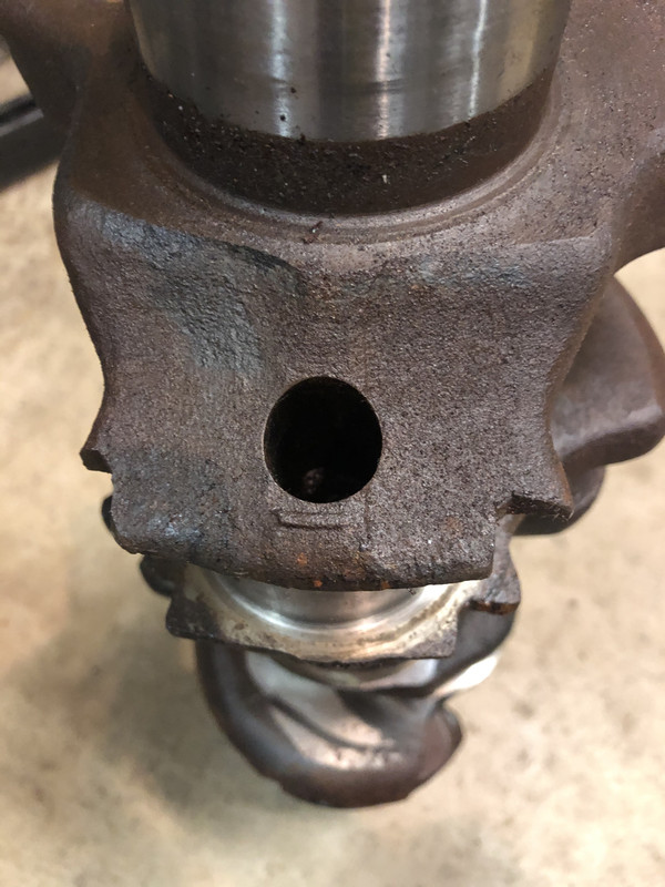

Does the 361 forged crank have solid crank pins?  As I am typing this I am thinking not?  Just wondering how crazy you could get with offset grinding it, if you wanted to.
pl
  • Posts: 1958
Re: 361 Industrial Engine
« Reply #10 on: May 08, 2021, 05:12:14 PM »
pl
This D2TE-A forged 361 crank I have sitting around has a small hole on the front & rear rod journals, no hole on the middle 2 rod journals.
If a 361/391 has been through a rebuilder they often have 3 ring pistons, the last couple I’ve taken apart had those.
