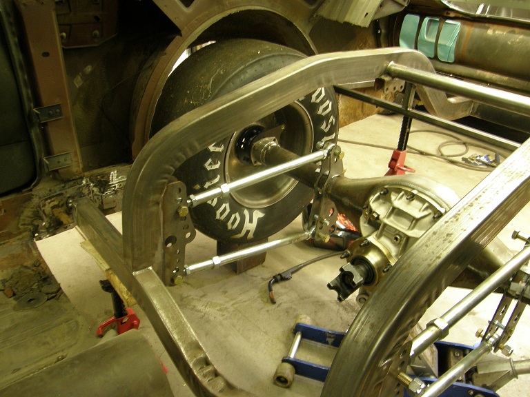

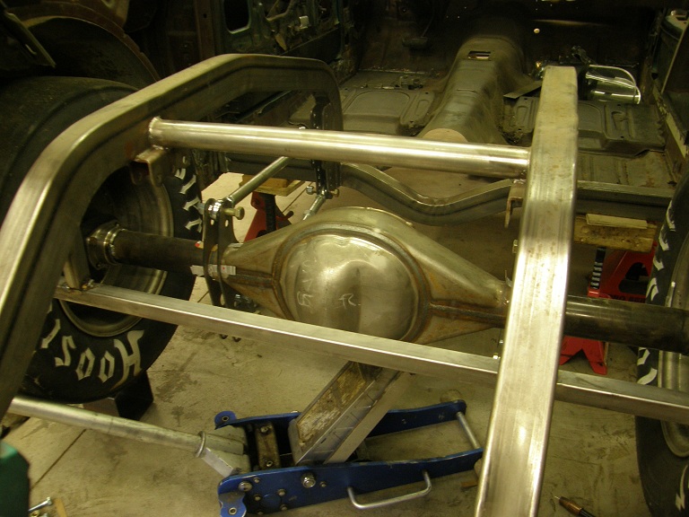

Friday morning after Thanksgiving I got out to the shop to get started. I checked the overall length of the Currie axle housing and it seemed to be right on, so I bolted my jig case into the housing, and slid the 2 1/4" steel tube through the donuts in the case so that it was sticking out of both ends of the housing. Next I took the four link brackets and slid them onto the axle housing tubes; this had to be done now, because they wouldn't fit on over the housing ends. Then I took the Mark Williams housing ends and slid them over the steel tube with the donuts in place inside. They looked like they lined up perfectly with the axle housing, indicating everything was straight. Finally, I dug out my wire feed and tacked the housing ends into place.
I am always extremely cautious when welding on the rear end, because I want to be sure not to warp anything, so I basically put three button welds spaced 120 degrees apart on the housing end to axle housing joints. I welded one side first, and then the other, and then went back and forth with the button welds until I had a bead about an inch long in three places around each axle housing tube, tacking on the housing ends. I will finish weld this later, when I finish weld all the other components onto the axle housing, such as the back brace, four link brackets, rear sway bar brackets, etc.
Next I removed the jig tube and the aluminum donuts in the housing ends, and unbolted the jig case from the axle housing. Then I bolted in the Mark Williams case, and installed the forty spline axles into the housing. Thankfully, they seemed to be the correct length and fit perfectly. Then I horsed the rear axle assembly up onto a floor jack, and rolled it around to the back of the car and positioned it underneath the back half frame rails.
Next step was to add the four link bars to position the axle housing correctly with respect to the back half frame. I assembled the rod ends on the four bars and made sure that each bar was exactly the same length, then bolted them into the brackets on the back half frame, and then onto the brackets that were on the axle housing. Finally, I screwed the drive studs into the axle flanges on each side, slipped on the Wilwood disc brake hats, and bolted on the wheels and tires.

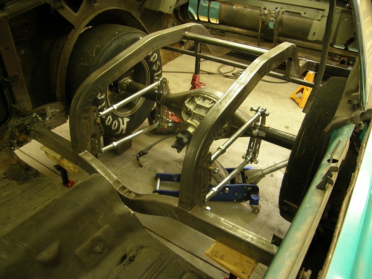

As the wheels and tires went on it was clear that the back half frame was positioned too far to the rear of the car. I had a floor jack supporting the front of the back half frame crossmember, and jack stands supporting the rear, and another floor jack supporting the center of the rear axle housing. I moved the floor jacks together to get the tires positioned directly under the wheelwells, and then jacked up the rear axle housing to get the tires positioned up in the wheelwells like they would be with the car sitting normally.
When I had the wheels and tires where I wanted them, and the four link setup assembled, I was finally able to position the back frame rails in the proper position side to side, and mark them so that I knew where to cut them off so that they would fit up into the trunk area and butt up against the 2X3 rectangular steel tube that I had already welded in place there. After marking I dropped the back half subframe off the jackstands in back, and cut the subframe rails off with a cutoff wheel in my grinder. Then I repositioned the back half subframe under the car, and moved it around until I had it in the final position. I cut the 1/8" steel plates to go against the rocker panels for the front crossmember to weld onto, and locked them in place with some vise grips. After double checking all the measurements to make sure that the back half subframe was straight and square in the car, I tacked it into place with the wire feed.
It was now getting towards the end of the day, but there was still one more thing I wanted to accomplish. I had purchased some 1" X 1" 16 gauge square steel tubing to kind of frame up the trunk area, and provide a reference for the tops of the trunk drop downs. I was able to add in this framework pretty quickly, again just tacking the pieces in place. Here are some photos of the back half subframe installed in the car:

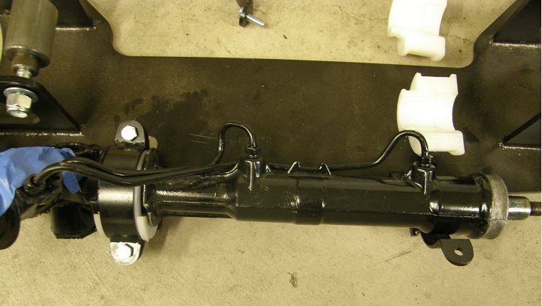

Next I went to bolt the rack onto the K member. The K member had two U-shaped brackets welded to it that the rack fit down into, bushed by a couple of large nylon bushings. The two nylon bushings were each split in half and fit around the rack, and then the assembly fit down into the U-shaped brackets. Two more U-shaped brackets were provided to clamp over the top of the brackets welded to the K member, to keep the rack in place.

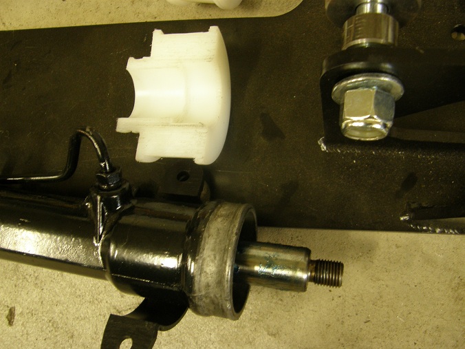

Again with this assembly, I ran into problems. The split nylon bushings fit correctly around the driver's side of the rack, but on the passenger side, the nylon bushings weren't even close to fitting. At first I thought this was an access issue, so I pulled the K member back out of the car to fit the rack into it (it came out a lot easier than it went in). But it turned out to be the bushing. Here are a couple photos showing the rack and the associated U-shaped brackets on the K member, and the nylon bushings:
Rack not fitting properly 1
Rack fit problem at passenger side
After this last disappointment, I called it a day in the shop. No way I was going to resolve the issue of the missing spacer and the incorrect rack bushing without calling the manufacturer, so I sure wasn't going to be able to get this setup installed over the weekend. I went in the house and adjusted the schedule on my spreadsheet to reflect this reality, and hoped for a better day on Sunday.
