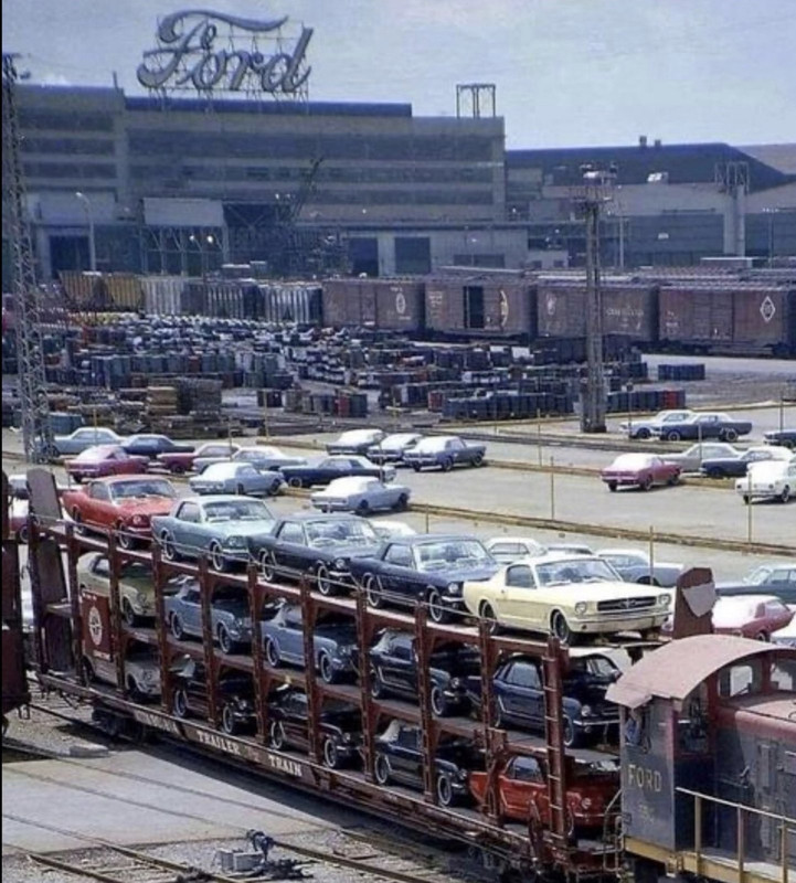

What strikes me is the difference/care/love/fanaticism in the engine assembly today versus the slapping together of an engine in the plant. Awesome just to watch them slam pistons in.
Obviously we want more out of the engine but still.
Coincidentally this popped up just now in my wife’s Instagram dealy.
« Last Edit: March 26, 2021, 08:08:54 AM by turbohunter »

That's a lot of Ponies!

Haha, I saw that part of the video- the operator was launching a ring compressor on and whacking the piston in with a dead blow without even looking at it.
