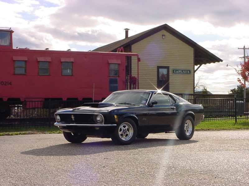

Late to the game, but I run the same, 275/60-15, 5.5 inch BS on 8 inch rears, front are 7 inch, not sure of BS.  In this pic, 215/65-15, but later went 235/60-15.  Both looked good, 235's a little more beef to them

Thanks Ross! Say, is that a Boss 9 scoop?
I looked long and hard at one for my '70 Mach1 but thought it was a tad too high. Then, I looked at the similar almost identical hood on a Cougar Eliminator at a car show and found the shorter height looks perfect. Cut a hole and threw one on last year. Will update my pic here once she comes out  of her deep Winter sleep as it's 1 degree here in suburban Chicago, 15-16" of snow on the ground and more coming today!
Re: 1970 Mustang: biggest rear street tire width & rim width. Fronts too.
« Reply #6 on: February 15, 2021, 09:28:17 AM »
Yes it's a Crites Boss 9, some of the others are a bit taller, this one is very close to accurate, and I located it based on a survivor that was in VA when I put it on.  I don't even notice it other than it makes you feel a little tougher when driving. :)
