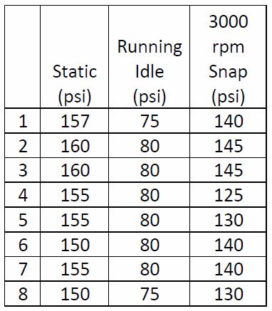

Ross, here are some answers:
1.) I have completed a dynamic, running compression test and here are the results. Static compression looks good for 9.5 CR pistons. All of the 3000 snap readings are too high, suggesting some restriction in the exhaust system. What next? My Mustang has a complete, stock exhaust system, complete with twin exhaust resonators and crossover muffler behind the rear axle. Remove the muffler?
 (This running test consumed three Schrader valves. The valves have a limit of how much pounding they will tolerate. Tried removing the Schrader valve, but the gauge was too difficult to read.)

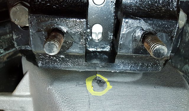

While I was lying on concrete, on my back and trying not to burn myself on the exhaust, inspected the TKO transmission mount. Thought this looked suspicious
Took a break to allow the exhaust to cool, moved the Mustang to the middle of the garage and put it up on four jack stands. Removed the transmission mount and found a contact mark where the transmission case and the mount were touching. Those are not cracks in the transmission case, just casting parting lines and a scratch in the aluminum.

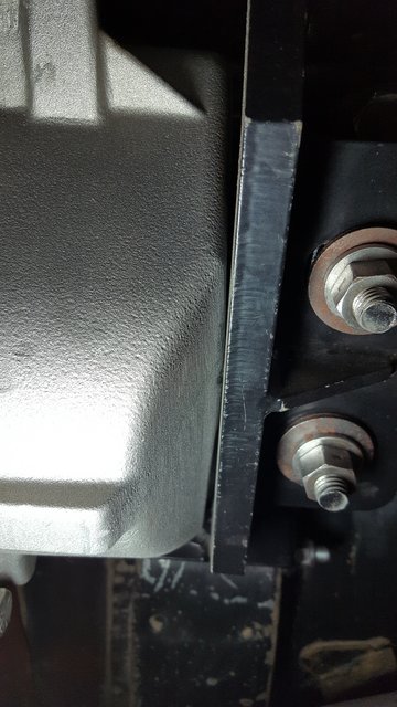

Found my vibration and the source of the 2000 rpm cabin noise!   :)
This is from an assessment by running the Mustang in the garage. There is too much embedded salt dust in Nebraska's roadways and a few snow piles still melting into the street, so I did not take it out for a drive.
After removing the interference between the transmission case and cross-member, the maddening vibration/sound is gone. :D Plus, the Mustang now has an updated ignition system. Another plus is the faint gear whirling noise at idle with the clutch out, that could be heard in the cabin is gone.

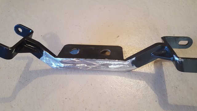

This clearance crack required alot of time with a 7" disc grinder. Had to weld the opposite side of the bracket because this clearance removed all of the origin welds. Will need to repaint it.
