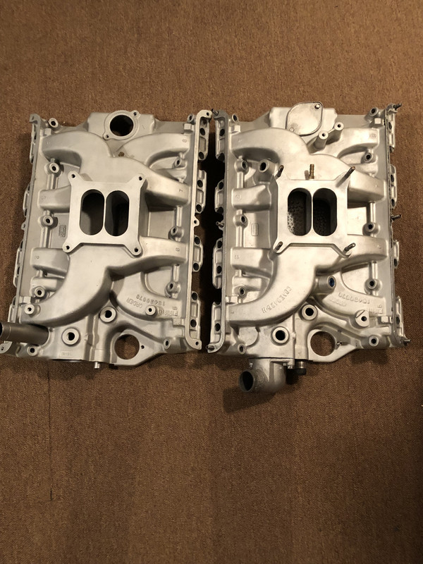

Did they have their own line of intakes?
Doesn't look like an F427 at all, and enough differences from a 428PI (although closer) to say they aren't that either
Neat intake

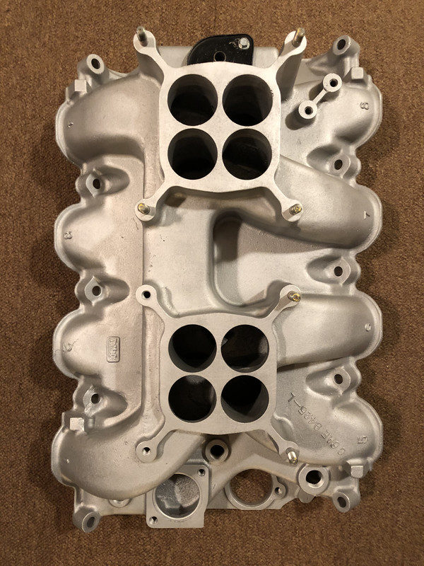

« Reply #16 on: October 31, 2020, 09:38:34 AM »
Kevin, on that HM intake what are the 4 small tabs next to the VC rails used for?  One of them has a small pan head screw in it. I've never noticed that before. Thanks.
I don’t know what the purpose of the tabs are, but they’re actually on most original Ford FE aluminum intakes, or the Ford based ones like that H/M. The tabs are on that ‘60 352 HP intake, they’re on these M/R & P.I. intakes, and they’re even on this SOHC intake. Maybe Jay can comment if he thinks they serve a casting or machining purpose. What’s noticeable on that H/M intake is that they’ve been drilled.  I don’t know if there was a purpose for the drilled holes? I bought that intake at a swap meet about 35 years ago and that’s how I got it.

Re: Single 4 Intake
« Reply #17 on: October 31, 2020, 10:02:43 AM »
Neat intake
Back then Ford and Holman Moody were such a cooperative effort it was hard to tell where one ended and the other began.The intakes were cast at the same places and in some cases such as some small block intakes they had intakes that were nearly identical sporting different logo's such as Shelby,Ford,Cobra,Tiger,and H/M.There were examples of parts being branded from one source and not the other,but Fords full line of performance parts were available thu H/M.
Re: Single 4 Intake
« Reply #18 on: October 31, 2020, 10:19:36 AM »
I think Joe is correct on those tabs, it looks like they are used to index the raw casting on the machining fixture, while leaving other surfaces open to be machined.

Re: Single 4 Intake
« Reply #19 on: October 31, 2020, 11:42:03 AM »
I always figured they were for the prybar to get the valve covers off

« Reply #21 on: October 31, 2020, 05:32:51 PM »
Something that appears to be consistent on the C5HM intakes that typically aren't seen on unmodified Ford intakes is the 3 barrel notch on the plenum divider,the time frame is about right for the introduction of the 3 barrel.The earliest 3 barrels were seen on Mopar 426 track hemis with Lemans bowls and I don't think Mopar had the same exclusive deal for a year that Ford had with Holley when they supposedly subsidized the development of the Dominator.The 3 barrels appeared to be available to all the manufacturers almost immediately.
