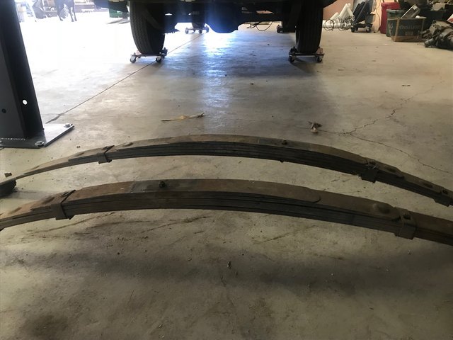

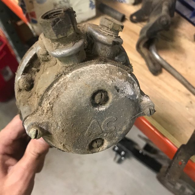

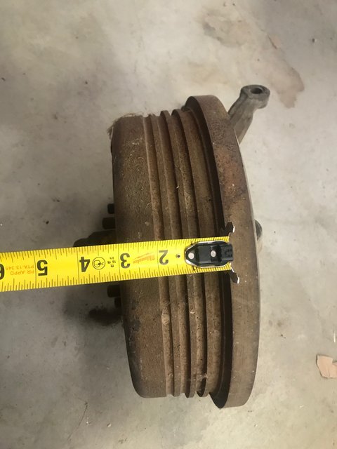

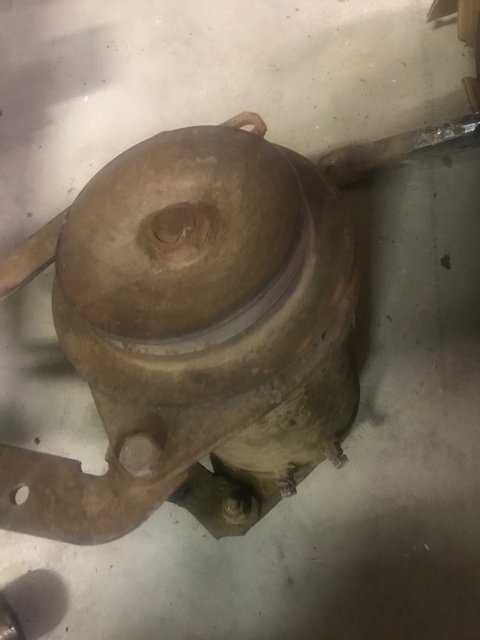

Here's the things you can look for fairly simply that aren't internal to the engine.
-3/8" fuel line
-AC 10 bolt fuel pump
-generator has large pulley
-3 row radiator, the core should fill up the radiator space front to back
-3" wide front drum brakes
-no power steering, no power brakes
-On the door data plate, needs to be a Y-code, the axle code spot left blank
-if you get lucky the KH wheels will be left on it with the cats eye slots in them.
-5 leaf rear leaf springs

OK  big gen pulley check.. Y code Check..no ps psb check. COAE D heads  check,  Shorty manifold check, 3 inch drums Check, 3/8 fuel line check,
I will look at the wheels, fuel pump, leaf springs. What is the correct carb list number?

« Reply #17 on: September 08, 2020, 10:22:48 AM »
If it has all that then you're pretty much there.
Carb is a Holley 2112 List. Part# C0AE-9510-AA
