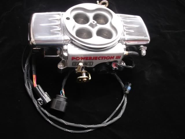

I'm in the process of changing my carbed 462 over to Powerjection 3.  I chose it because I wanted the benifits of injection and looks of a carb (no big fuel rails on my vintage intake).  I'm still working on the plumbing, so no report yet.  But it does look promising.
This was over on the FFR forum.
