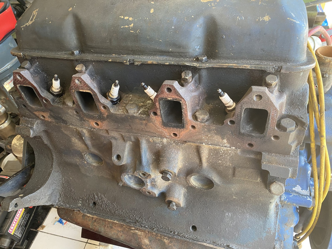

Now if I can get the damn exhaust bolts out without breaking them.

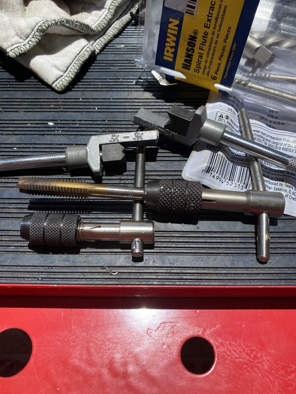

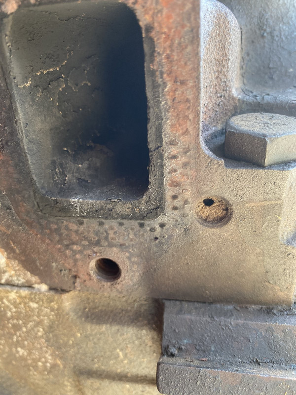

Got the logs off.
Let ‘em soak over night then hit ‘em with heat. Did pretty good but not perfect. I broke 3 tops all on one side but I’m calling that a win.
Have some good flat surface for drilling. Also someone tried drilling out before and didn’t get far so I have four to take out.
Had a resident at some point too.
Re: The FE gods have smiled down upon me.
« Reply #24 on: July 16, 2020, 03:05:31 PM »

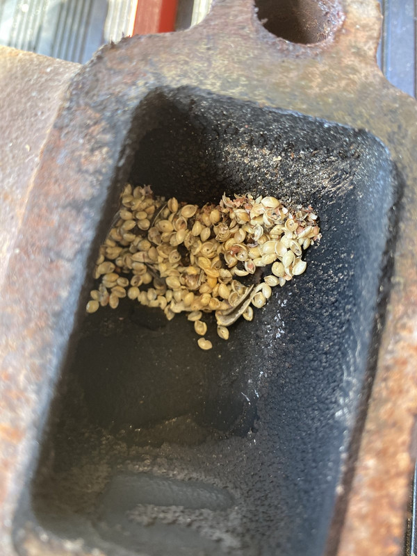

Well it took an entire morning but all bolt holes have been drilled out and no threads were harmed in the process. My hands are gonna be sore tonight.
The forth hole that I thought was a previous owner try at drilling a bolt out turned out to be mud.
It always amazes me how those damn threads can weld themselves in there. None would spin out. Had to use rev bits/forward bits/picks/taps/hammer/extractors etc. to get them out. Broke three tap holders.
But they’re out.
But they’re out.
Nice but hard work! Be sure to use lotsa anti-seize on those new bolts.

OK, I'llsay it, for us lesser mortals what am I looking at here?
