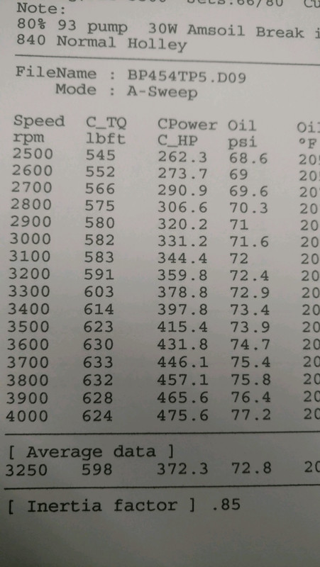

Blair wrote me and asked if I would post up these pictures and video of an engine he just completed and dyno'd.
It's a 469 cube 428 stroker. BBM heads, performer RPM intake. 537 peak hp, 633 peak tq. Blair can fill in more details.

9.75:1 static compression
428 service block, 4.190 x 4.250.  Safe cylinder walls.
.515 valve lift, 218/218@.050, 110 separation
BBM heads with my cnc chamber program, light hand porting, proprietary valve job, 2.200/1.660 valves.
Performer RPM with some porting and plenum touch up.  No divider cut for this application.  4-hole wood spacer.
Custom Holley carb.  Started life as an 1850 main body.  Finished carb, 4150 style, 840 cfm, vacuum secondary.
Good rocker shafts, billet stands with supports, non-adjustable OE rockers with tight shaft clearance.
Cometic head and manifold gaskets.
Full length 391 oil pan with internal mods, Canton screen.
Idles smooth at 850 rpm when warm.
FPA tri y truck headers 1-3/4 primary x 2-1/2 outlet.
31° total timing
Blair Patrick

Holy cow, that torque curve! The fact that it's so flat, and with such a conservative camshaft on a 110 separation, shows how little I know about camshafts. That's an impressive towing engine though! And the fact that it was done with 31* of timing shows how efficient the chambers must be. Should be able to live on about any fuel also. Very nice, Mr. Patrick.

It's a hydraulic roller with custom lobes.  I think it would be really hard to get the torque down low with a flat tappet.   The carb has center hung bowls and metering blocks on both  ends.  1.320 venturi, 1.686 baseplate, with special boosters.  We just used the 1850 main body to get something small enough to work with.  The entry is reshaped and it is re-tapered under the venturis to match a 780 base.  We did it with low lift and OE rockers with nothing to fail, with intent for years of service.   I've been joking about it being an FE Super Duty.  The chamber is really good, and this program finishes it off real nice.  31° timing, huge low lift numbers, flows a little over 300 at .500 lift, 235 exhaust at .500 lift.  I don't post everything we do, but this was kind of a fun and different type engine, and I thought it would be of interest to the truck crowd, of which I am a member.  I sent Mike some more pics to post.  He'll catch me up I'm sure.  I'm just an old hillbilly and not smart enough to post all them pictures.

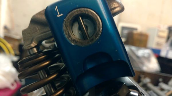

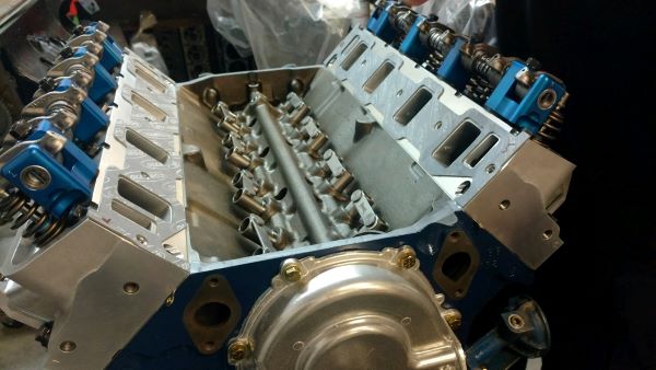

Here's more:
