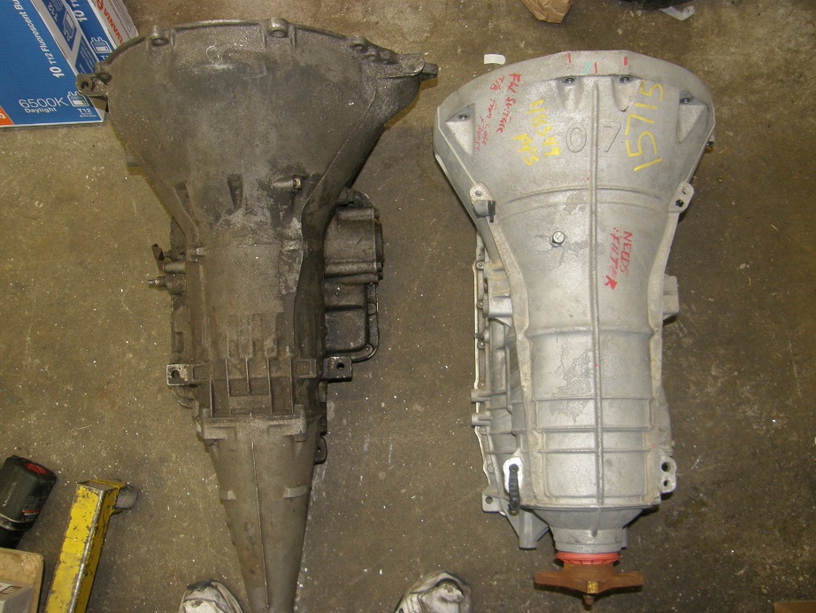

I just pulled out an FE C6 and measured it; at the centerline of the shaft, the C6 is only about 8" wide, where the 6R80 is quite a bit thicker, and thicker for a longer distance.  Here they are side by side.  I think you'd need to cut the floor...

thanks Jay
That picture is exactly what I needed.
I don't mind cutting the floor. It has all ways been a race car so it will never be a concours restoration. I don't think I will have to cut to much and hope the console will hide it.
I can fab a floor to fit it fairly easy.
I guess I need to start ordering parts and the trans so I can mock up the unit and see exactly what it will take to make it work.
If there is any interest in the conversion I can post some pictures when I start.
It will probably be in Oct. before I will be able to get on it.
Greg
