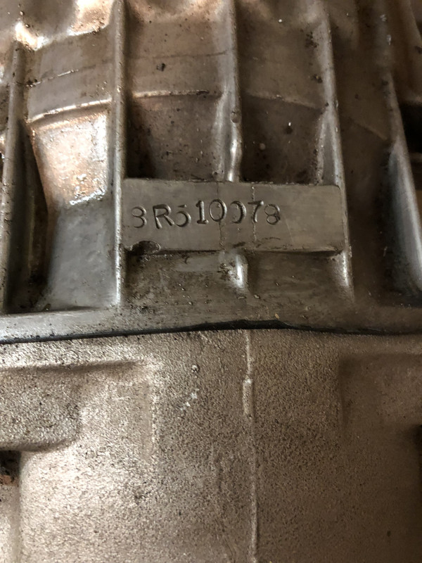

« Reply #17 on: January 16, 2020, 05:13:39 PM »
Just a thought, is your current C6 the original one for your Mach 1? If it is, it should have the partial VIN stamped on it to match your car. I understand your desire to get a replacement to get your car back running, but you might want to hang on to original to keep with the vehicle for the future. If it’s already been replaced then you can ignore this, but I just wanted to mention it because not everyone realizes about the VIN stamping.

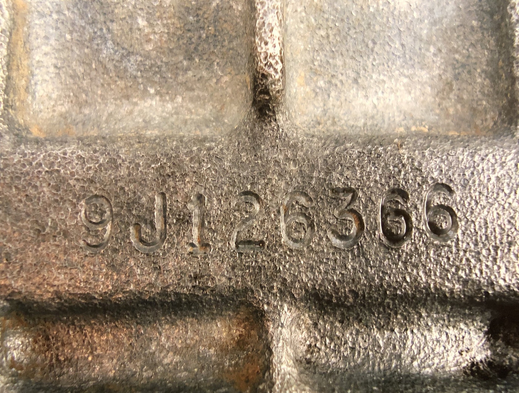

I can check.  I have not scrapped anything at all, and I plan to keep all of the take-off parts in storage just in case I get the itch to do a concourse restore someday, or if I have to part with the car for some unforeseen reason and a future buyer wants original parts.
Here’s a few examples. Usually stamped on the flat pad near the tailshaft. Sometimes distinct, sometimes faint. In general it applies to 1968 model years & later cars in our FE era.
