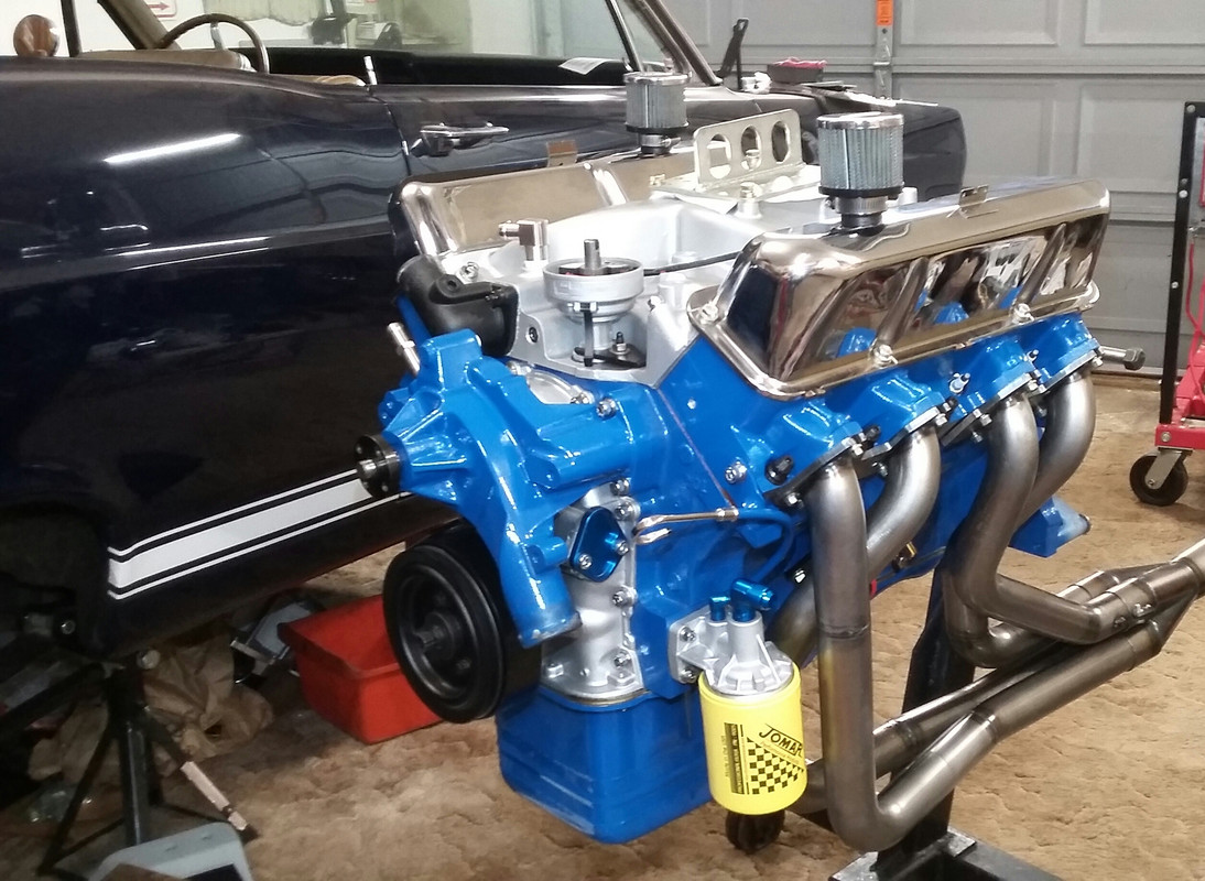

  • Posts: 307
I 86'd the power steering from my 67 Lane completely. With headers, fitment issues and the system nearly always leaking I'd simply had it. Ripped it all out and spent $150 on one of these:
https://www.autokrafters.com/p-10348-control-valve-eliminator-1966-70-ford-fairlane-1966-67-falcon-1967-70-mustang-more-power-to-manual-steering-rp27483.aspx
Never looked back. If you have low profile tires there will be few places you will miss power steering.
