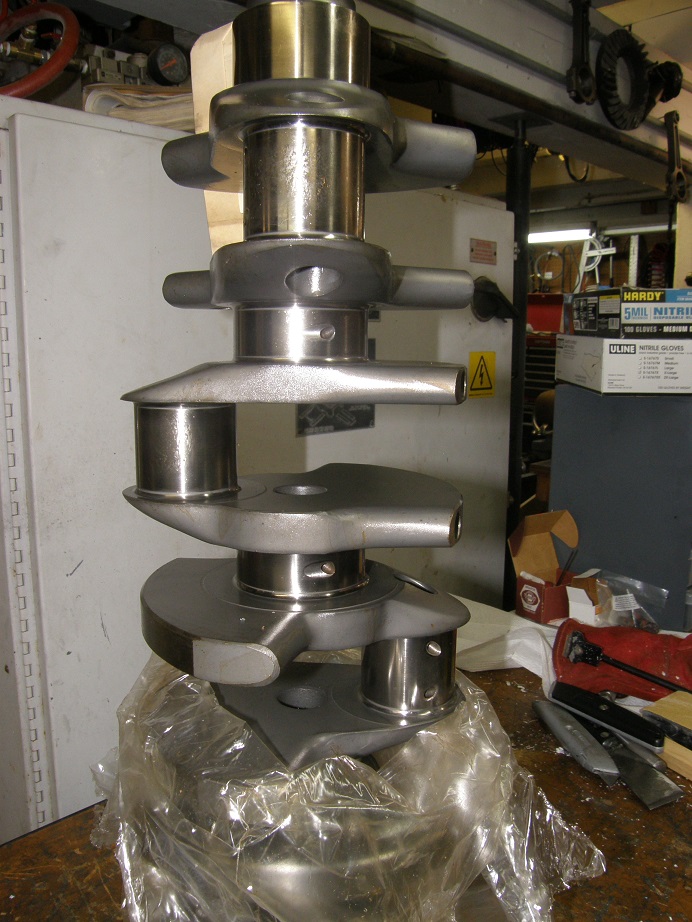

Trying to find a pic of an FE long stroke crank
Ricky.

Ricky, here is the longest stroke FE crank you are EVER going to see LOL!  4.750" stroke, stock main bearing size, 2.100" rod bearing size.

Mr. Blutarski, that overlap looks to be ZERO-POINT-ZERO on the big FE crank :D

That crank can reach out and touch someone.   ;D

Wow !!   :D
Thanks Paulie
Thanks for pic Jay
Ricky.

Someone is making a 390 into a 490.
