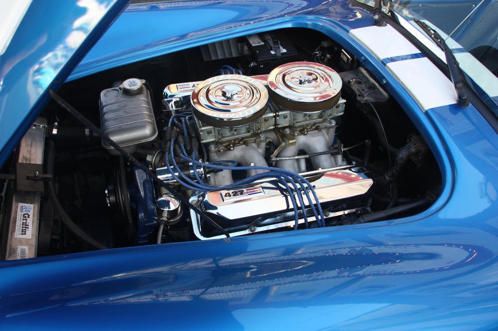

Did you consider looking at the earlier valve covers factory style covers? They make an cover like the Cobra covers that are just cast and finned. I have the factory cast Cobra 427 on my 67 Shelby. I have end stands and rollers with no issue.
                                                                                        -Keith
